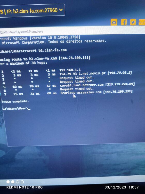

Yesterday i decide to make a trace route cause last few days this is getting worst im using google dns already call my internet provider and they cant do anything about any ideas how to  change route without spending money ?

All in all, the traceroute looks okay. Keep in mind that the ping displayed in the scoreboard in ET is considerably lower than the actual ping and also dependent on your framerate and the amount of packets you send to the server (cl_maxpackets).
There are two ways you can change the routing of your packets to the server: (1) change the ISP, (2) use a VPN. Option (2) I would discourage because one, your traceroute looks decent, and two, close to all VPNs have far worse routing for gaming than the routing offered by reputable ISPs, and especially free VPNs (higher round-trip times, higher jitter, packet loss).

looks like you´re having packetloss during tracert.
The time-outs at hops 3, 4 and 6 most probably happen because the routers at the specific hops are set up to discard and drop incoming ICMP traffic. As a rule of thumb, if packetloss and ping spikes at a specific hop do not carry through to the target destination (final hop) they are irrelevant and an artifact due to how the routers are set up to answer to incoming ICMP traffic (either completely drop it (=> "request timed out") or to treat it with the lowest priority, thus often answering only belatedly (=> ping spike)).
In general I would recommend using PingPlotter for monitoring your connection. All the things you can do with PingPlotter you can also do with the command line but interpreting data is a lot easier with corresponding graphs.
