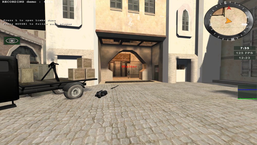

Today it was like that  (look lagometer)
That lagometer looks better than mine does, from West coast USA to East Coast (Jay1,2,HardCore,Silent#1, NQ#2)
My lagometer looks much 'worse" to beg1/jay3, beg2/Silent2 and NQ1.  That is to be expected, given the distances.
When I get any lag, I first suspect background processes on my own computer.  I have rarely had to restart my modem/router or my computer to fix network problems.  I only try those two fixes when all of my Internet is FUBAR! 😄  I think that players of real-time first-person shooters like ET are much more 'sensitive' to any kind of lags.
The delays that we get with webpages loading would be Intolerable with ET, INS, DOI, etc!  Of course, the more images, videos and advertisements on a webpage, the more delay. 😄

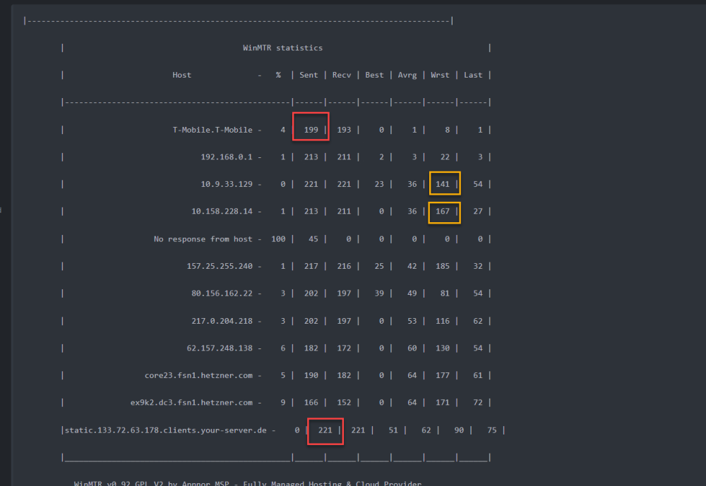

No response from a Host is not an issue. It just means either because of QoS - it's not responding OR ICMP is blocked. On our machine we do same.
1. One thing seems odd in your winMTR is - how you are sending 199 packets to first hop and server has more then that? I am guessing, some packets dropped at first hop?
2. For latency spike focus on rectangle highlighted in Orange.
Sorry for the late reply, I did a fresh test right now and from what I saw server goes ahead when it was about 30 packets sent.
