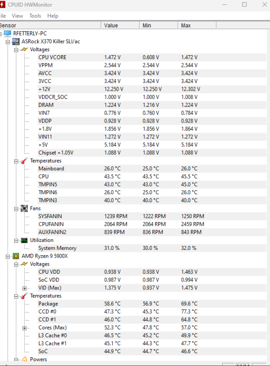

33 minutes ago, oliveirapt said:
Intel(R) Core(TM) i5-9400F CPU @ 2.90GHz   windows 10
how can i Check/Monitor your cpu and gpu core temperatures and the clockratings while playing.
Minimize the ET window when the frame-loss happens, see if differences in cpu+gpu clock Rating or temperatures occure.
(Etlegacy supports minimizing, Et2.6b uses a minimizer)
One easy way is, open the windows buildin task manager and check the performance window.
You will see your cpu+gpu usage.
Another program is aida64.
Its a freeware tool for 30days.
It will show you also temperatures and clockratings.
On the whole subject i can recommend reading this site:
https://geekflare.com/check-cpu-temperature-windows/
Remember, this is just a guess in the wild. Based on your delivered info its very hard to guess, but steady framerate and sudden frame-loss sound like a hot system.
