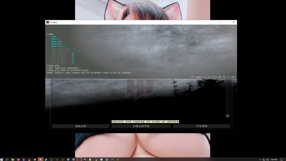

I choose the mod and then the demo on legacy the same way I'd do it in my vanilla client but it gives me that error only in Legacy. I'll try doing it in the command line and see if it works.  If not I guess I'll just move demos to my vanilla client to watch.  I have SunLights program too,  but they're just my own demos so I don't need any of the tools it has.
Edit: Sexy SS with more info
I think the demo_play command is for playback of the ETLegacy server-side demo feature. Which is why the error message says “.sv_84” instead of the usual “.dm_84” for a client demo.
Try this in console with just the “demo” command:
\demo 2021-03-19-002647-cean2
That command just brings up "couldn't open 2021-03-19-002647-cean2.dm83"   Idk why it say's .dm83, they're definitely .dm84's in my directory.
I doubt this covers the whole issue but it should be caen2, not cean2

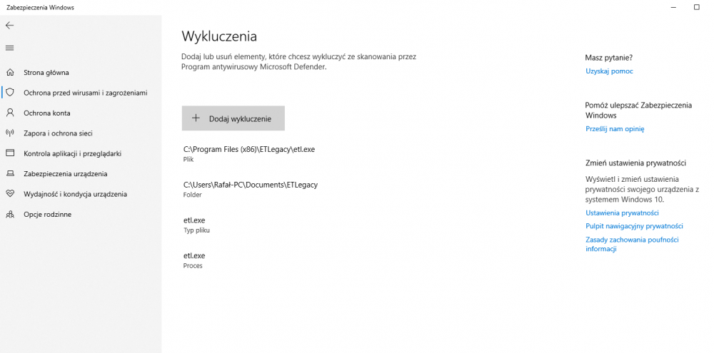

I don't know if this problem is fixed or not but I'll try to help anyway.
First thing you need to do when you start using etl is to add ETL to windows exceptions.
Instruction how to do it :
https://support.microsoft.com/en-us/windows/add-an-exclusion-to-windows-security-811816c0-4dfd-af4a-47e4-c301afe13b26
This is how it looks like on my PC (warning!! polish language lol) :
When you have it done, now you need to do the same in your antivirus firewall or in any other protection if you have any ( I don't )
Now you should be able to do screenshots , record demos etc
