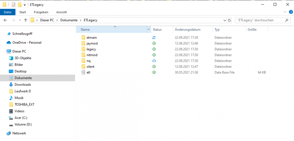

You need to connect to silent, jay, NQ or nitmod server with ETLegacy to download mod files. Folders will create by themselves. You can also copy-paste old folders there.
Imo no all time download mod,maps etc but still filders dont save same maps in etmain ?
C:\Users\"YOUR-Windows-USERNAME"\Dokuments\ETLegacy
It is by default in your windows dokuments folder which should be similar like the above path.
Edited by Vice86
This should work for everyone:
C:\Users\%USERNAME%\Documents\ETLegacy
You can change it in your response Vice and delete this.
