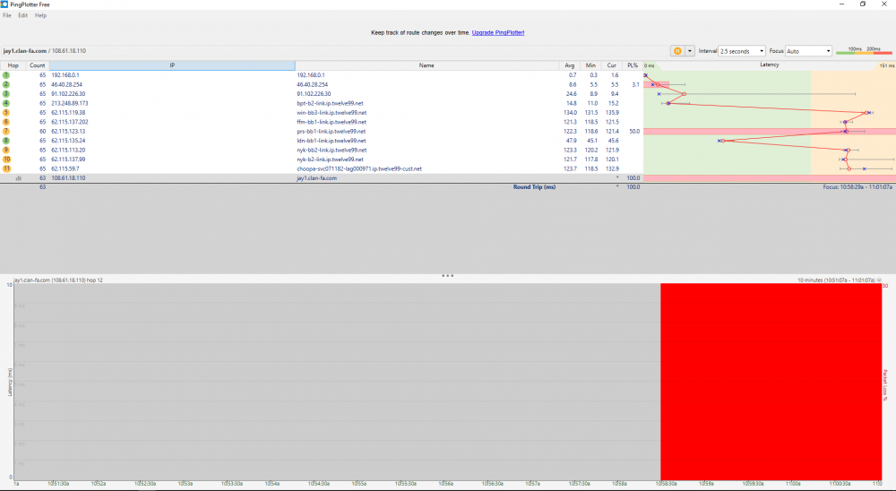

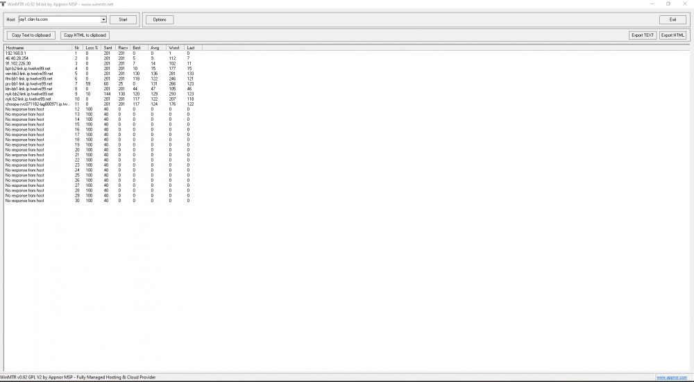

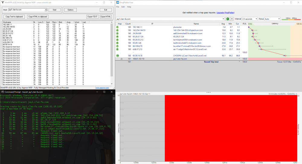

Just checked jay1 and I'm still having the same issue your having.  Other FA servers are fine.  Has been this way since the last time I played about a month ago.  Guess I'll be looking into it as well now.  I'll let you know what I find out.
Update.  Ran tracert, mtr, and ping plotter.  ? @daredevil
@FeintTry running the same and see what you come up with.
Telia peering seems a problem in this case. Please open the ticket at your ISP end. I have also opened a ticket from datacenter side.
