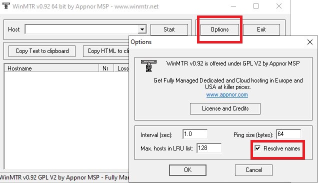

Your WinMTR results files show IPs in the IP address ranges of
    10.0.0.0     - 10.255.255.255, and
172.16.0.0     - 172.31.255.255
Could you set your WinMTR to "resolve names"  and then run it again during a normal connection to NQ#1?  I would like to see what those "reserved IPs" in your report actually 'resolve' to, Perhaps they are part of your ISP's network or somehow Internet Nodes in Turkey are using those IPs. :?:
