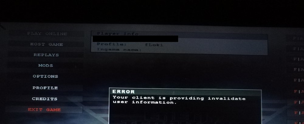

Hey guys
I start playing on allies team and found my self kicked by server
Dunno why
Here a screen shot
Hoope you can help

I have also received the error/warning of "Your client is providing invalidate user information", but I don't think that I have been kicked for it.
Maybe I was thinking of the "...invalid information." error, which I do see sometimes.  I was just testing on jay#1 and got the "invalid" error and was kicked when I intentionally made a "blank name". :hmm
I think that you should be able to restart ET or even just /reconnect to the server.
.I can look at the source-code for clues. ? .
I did a DuckDuck search for that phrase instead and found a topic on FA.  Several other sites say that it is a problem of a blank-name or a name with invalid characters in it (usually extended-ASCII characters).
The topic below made me notice that your ScreenShot shows your 'profile name' but that your  'ingame name' is blank!
You should be able to start ET, open the console and type /name FLoki.  Do that before trying to join any servers.
Several other sites also say that a blank-name will cause this problem.  If you use the FA-name change option in our menu, then Do Not remove all the characters!  You must have at least one character in the edit-window as you change your name.
