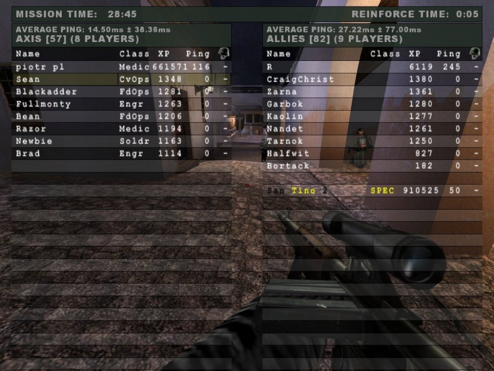

this, what I meant, when I said that it was months in jay3 that my latency had worsened from 45-50ms to 60-70ms, even though I restarted my router, while before for 1 year I always had low latency, (45- 50ms)
today with much amazement, I noticed with happiness that things are back as they were before, it is surprising, something has changed in the routing from Italy to Germany, I do not know if the problem was in my ISP, or on the JAY3 server, because if I entered JAY1 my ping is always the same for 2 years, despite being in America, and the same applies to JAY2 I always had the same latency, so I was worried, because my accuracy had changed with 10-20ms more
I hope that this problem does not come back now.
I almost had the desire to play on JAY3, I think now I will do some personal tests, playing again on JAY3
I posted ms-dos result, and screenshots of my ping, to show DD, I'm not crazy, and this is proof.
I can not find the post in here I had put the previous information, which proved that from ms-dos, my ping was about 40, and then in the server it was 60
look now how it has changed for the better without me doing anything, but I had to wait many months before my latency mysteriously returned to its origins.
