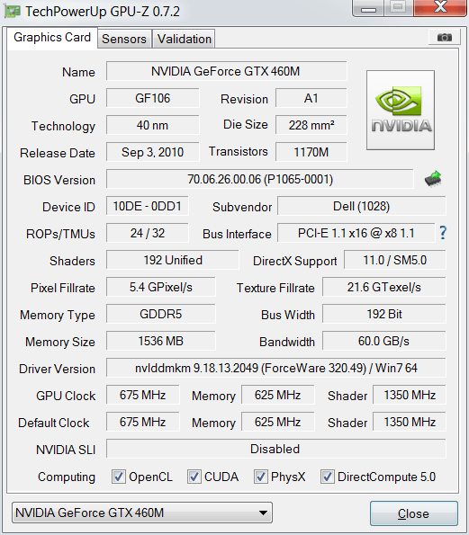

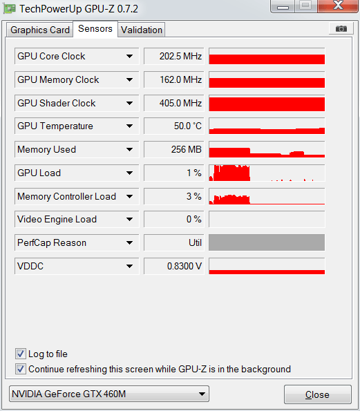

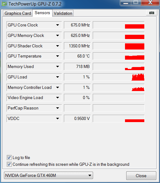

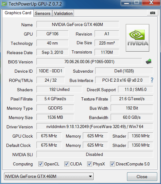

Administrators JoeDirt Posted August 10, 2013 Administrators Posted August 10, 2013 Download GPU-Z and monitor core and memory clock, same with CPU-Z while playing a game in windowed mode. Quote
Quovadis Posted August 10, 2013 Author Posted August 10, 2013 Edit : Nice fail , only 200 mhz on GPU clock ...... laptop not plugged in ............................. Quote
