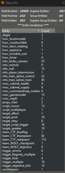

ok a2 version looks promising, i decompiled and check map info :
50% less entities and brushes, this map should probably be fine and cause no issues at all.
as u see there are 13 misc_gamemodel instead of 296 in b4 version, so like i said probably those misc_gamemodels are just waste of entities.
try this map and see if it causes any issues, if it does report here and ill have a look
idk which version i played in et tbh , but having less 10k brushes and 500 less entities means something major has changed in the map. lmk what u think
  • Thanks 2
That is a massive difference in entities. I'm curious about the differences between the two versions
Thanks Drempa for being so reactive.
Yes, on entities count perspective it looks highly promising.
3 hours ago, Armagedonyx said:
If you can fix this map, you probably could fix every other maps that crash on Jay 1, right ? That means we could have any map on the rotation.
I dont think there is much fixing to me made. The map is pretty workable as it is.
When i was first introduced to the game upon release, i was quickly drawn to a UK based server (Qubenet, dunno whether they still exist) where one of the server (the one i was practically sleeping in) was a helmsdeep a2 dedicated server, i.e. helmsdeep 24/7... let me tell you the server was often full everyday (though player limit was like 30 something).
It was before any major mod release so it was basically running under etpub.
Difference between a2 and b4 (as far as i remember) :
  • b4 basically added a lot of graphics details, most prominently the crystals in the cave, but also other entities.
  • Some area can unlock medic/ammo cabinet if a medic or a fops stands on it long enough. I'm not sure that feature exists in a2
  • The horn at tower top can be blown in b4 for various effects on players or explosion. I'm not sure that feature exists in a2
  • Not sure the final spawn for axis (attacking) is available on a2 (cp forward spawn inside the mines).
  • b4 added a depot defense (satchelable) before the final blow out objective
  • I don't think any routes or map structure changed from a2 to b4
I will make a more thorough check later running the 2 maps locally and get back here.
