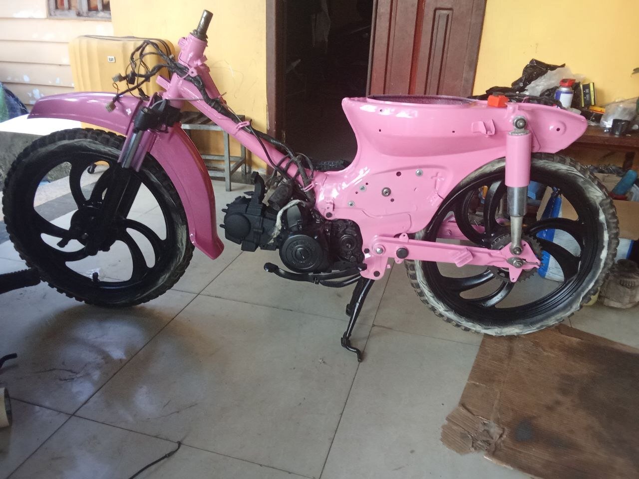

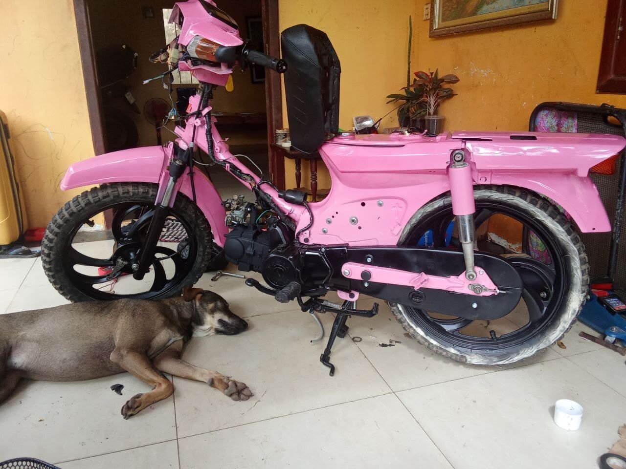

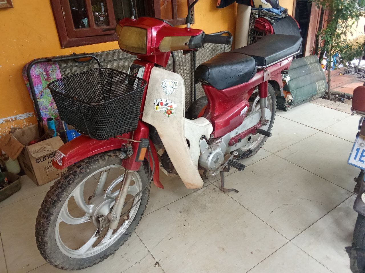

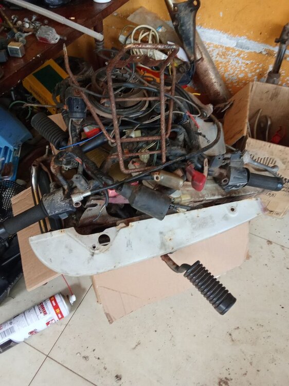

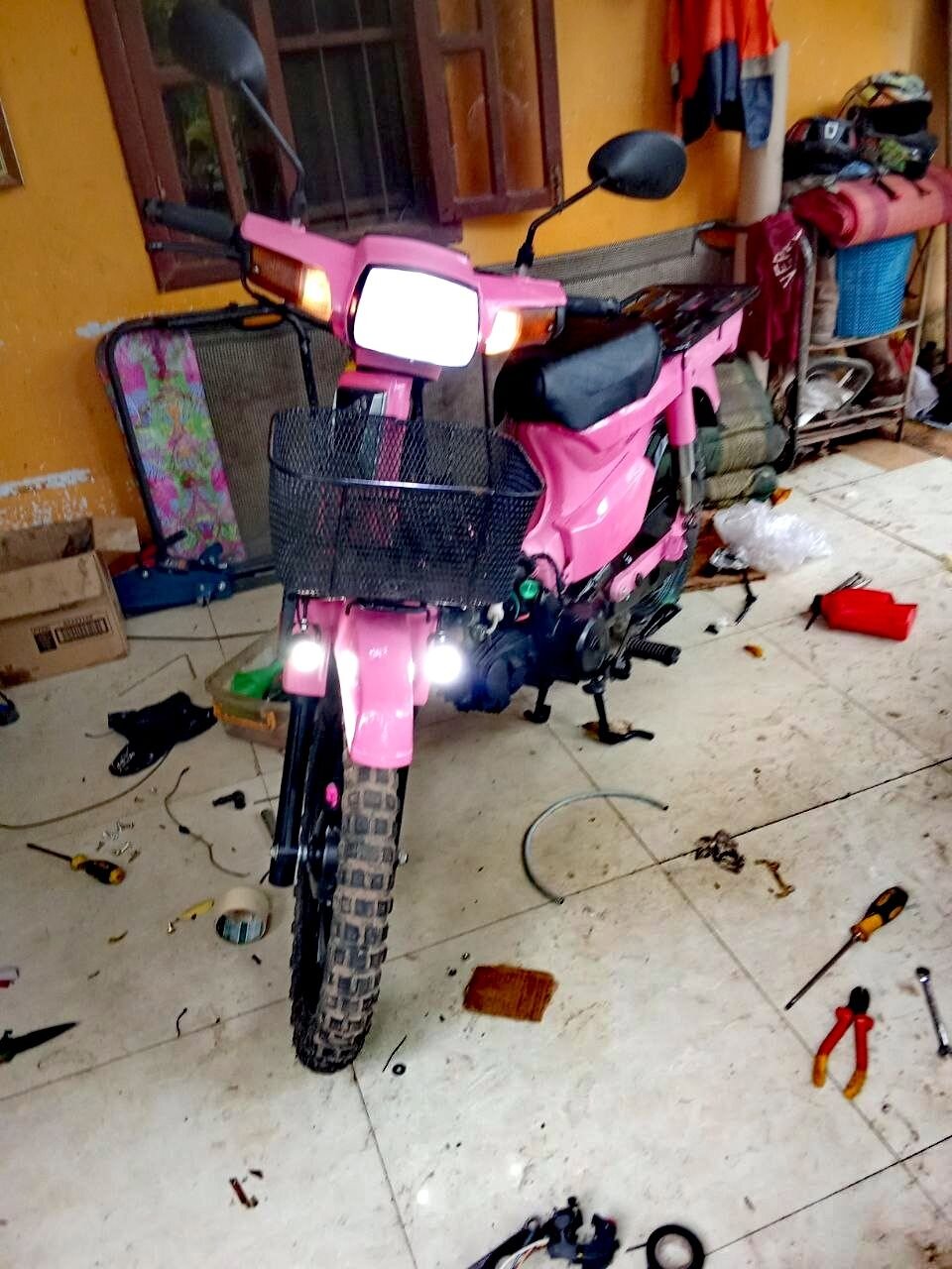

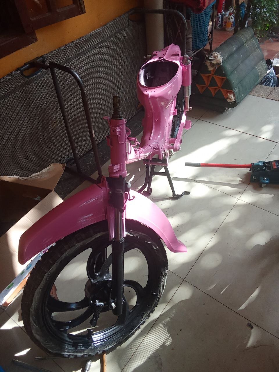

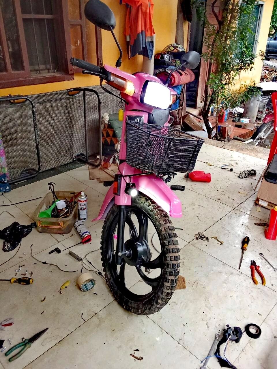

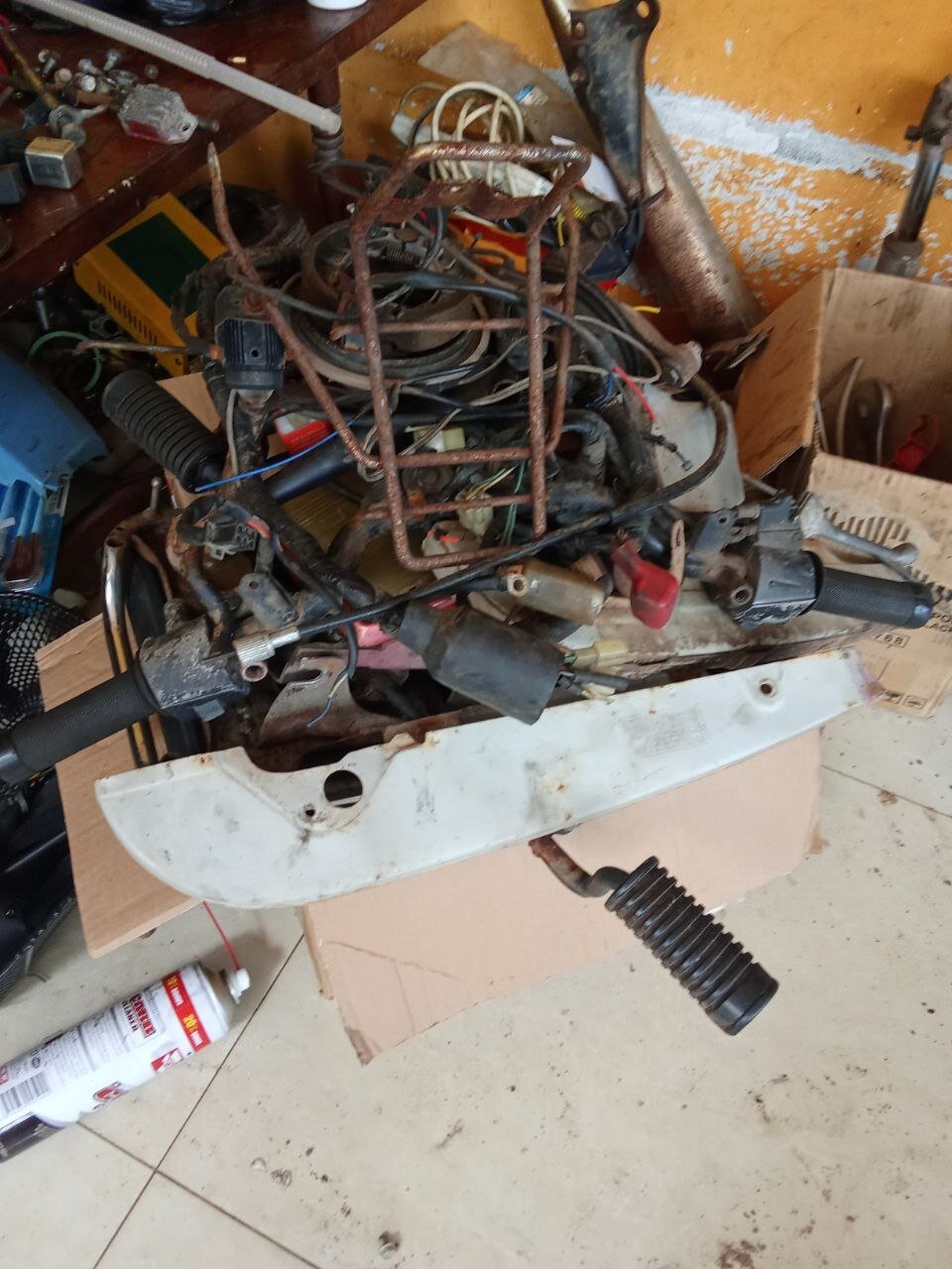

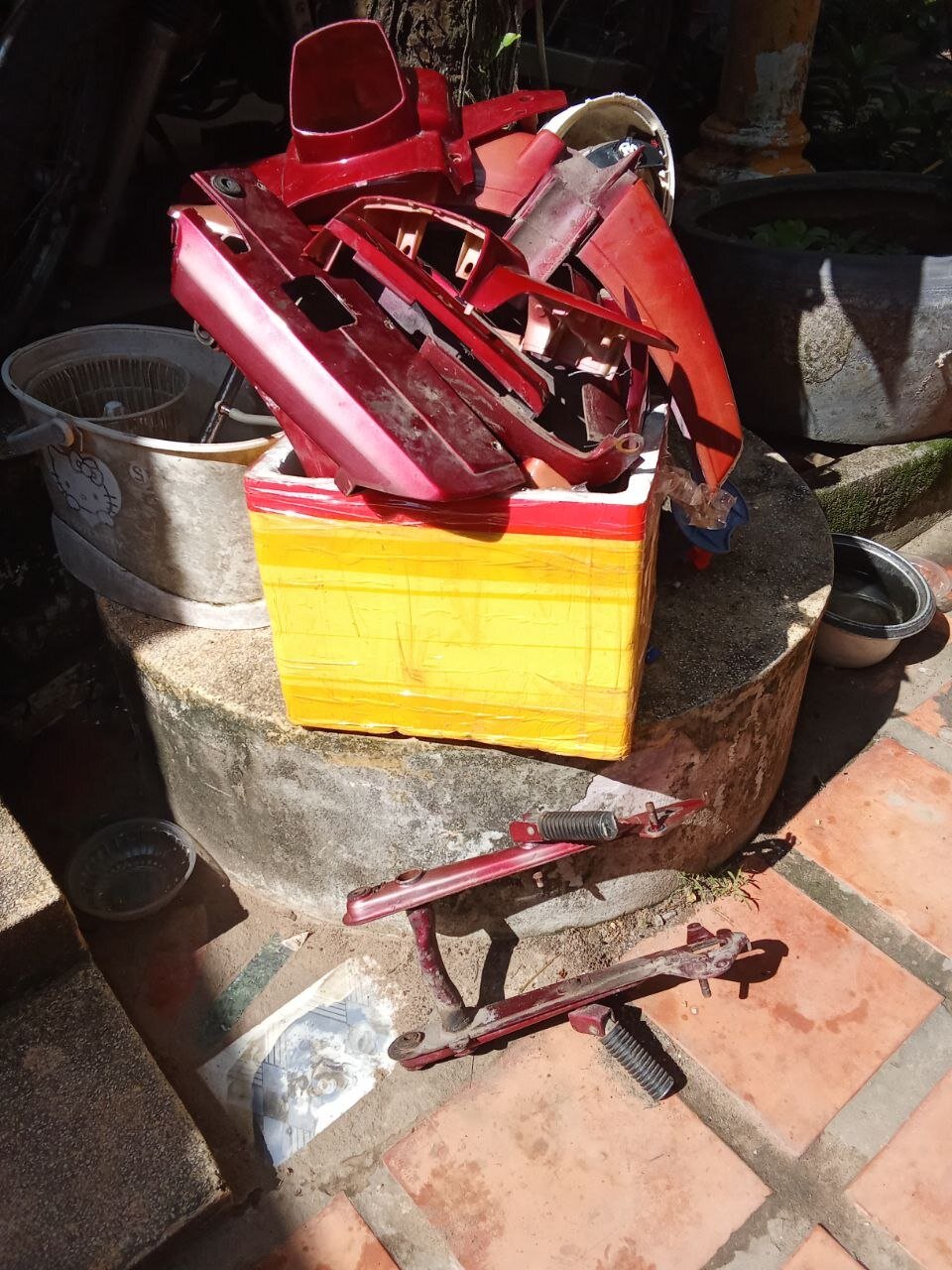

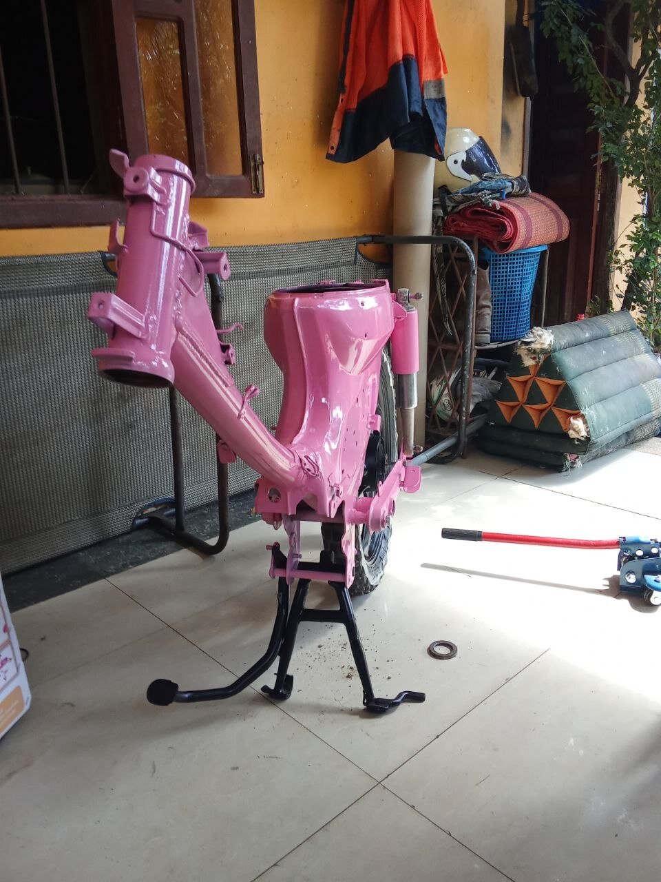

Around 20 hours deep in this little red Honda Daelim that it's owner wants made black + pink

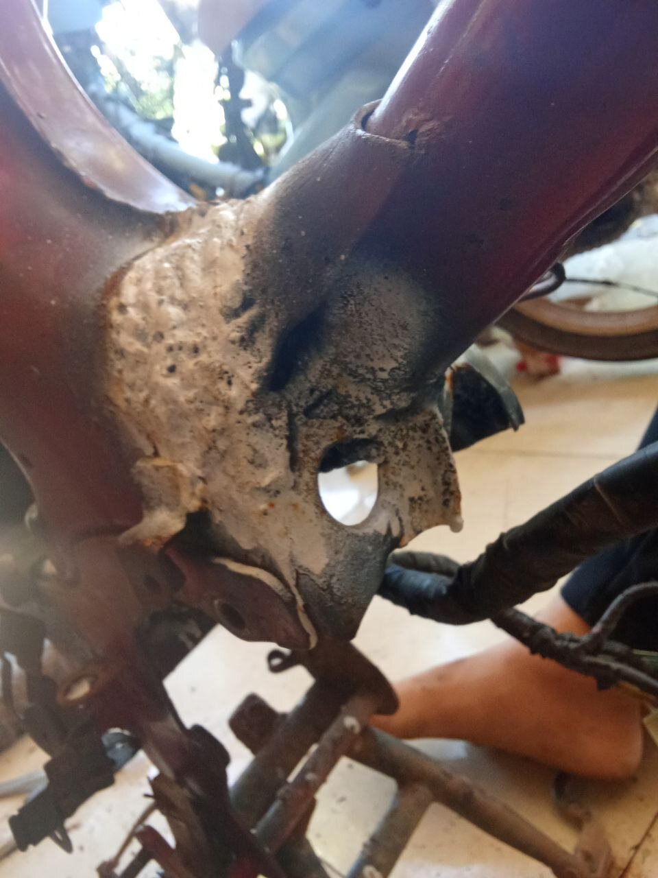

on stripping it we found frame rotten and very badly welded, bought a good replacement frame and  a new swingingarm for like $110

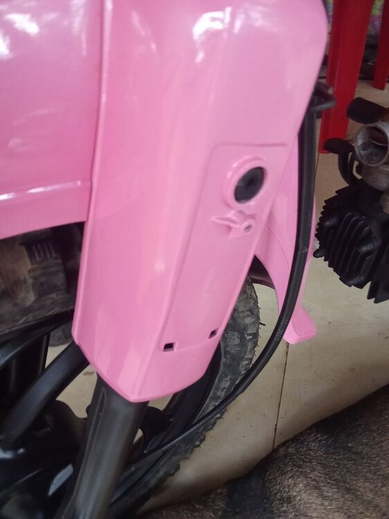

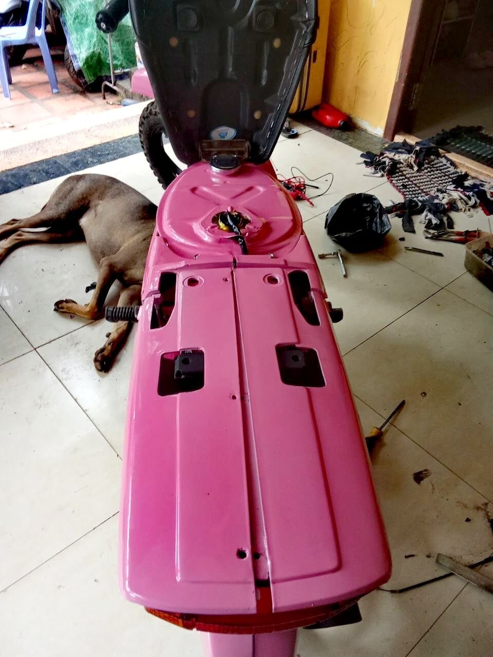

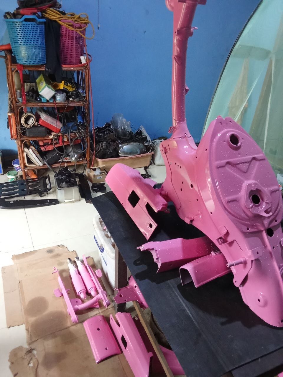

sent all plastic parts to paint barbie pink at paintshop for another $100

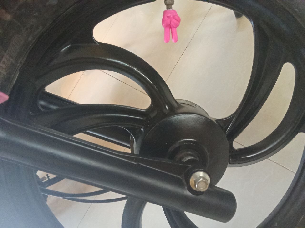

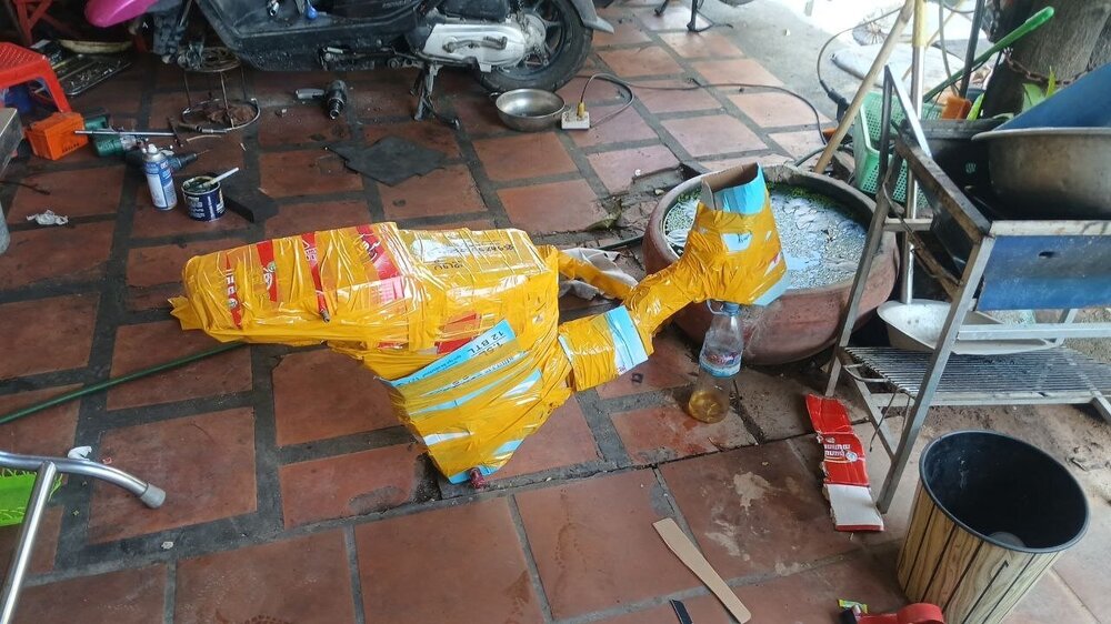

cleaned and sanded and painted all other parts flat black three coats and clearcoat also

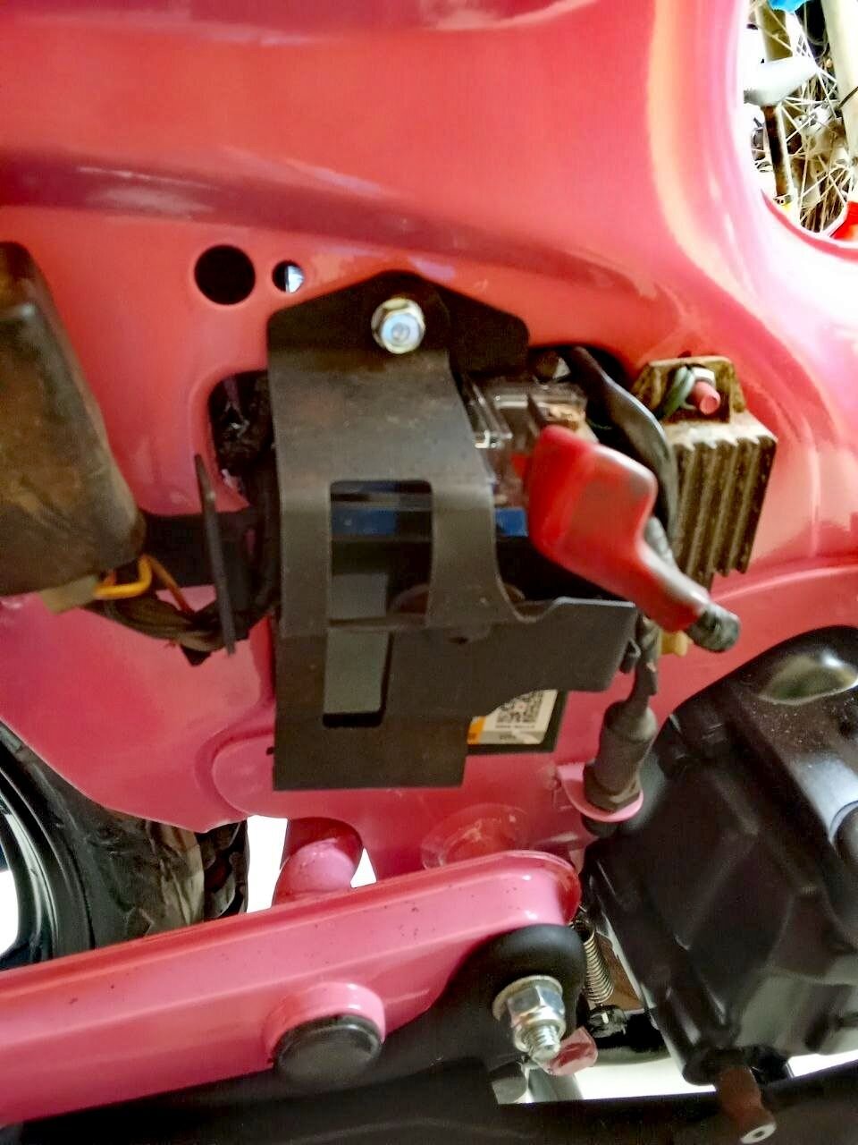

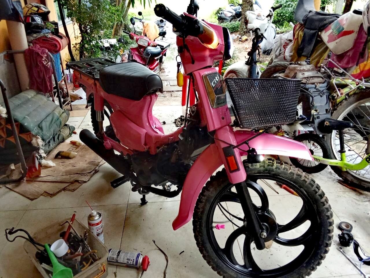

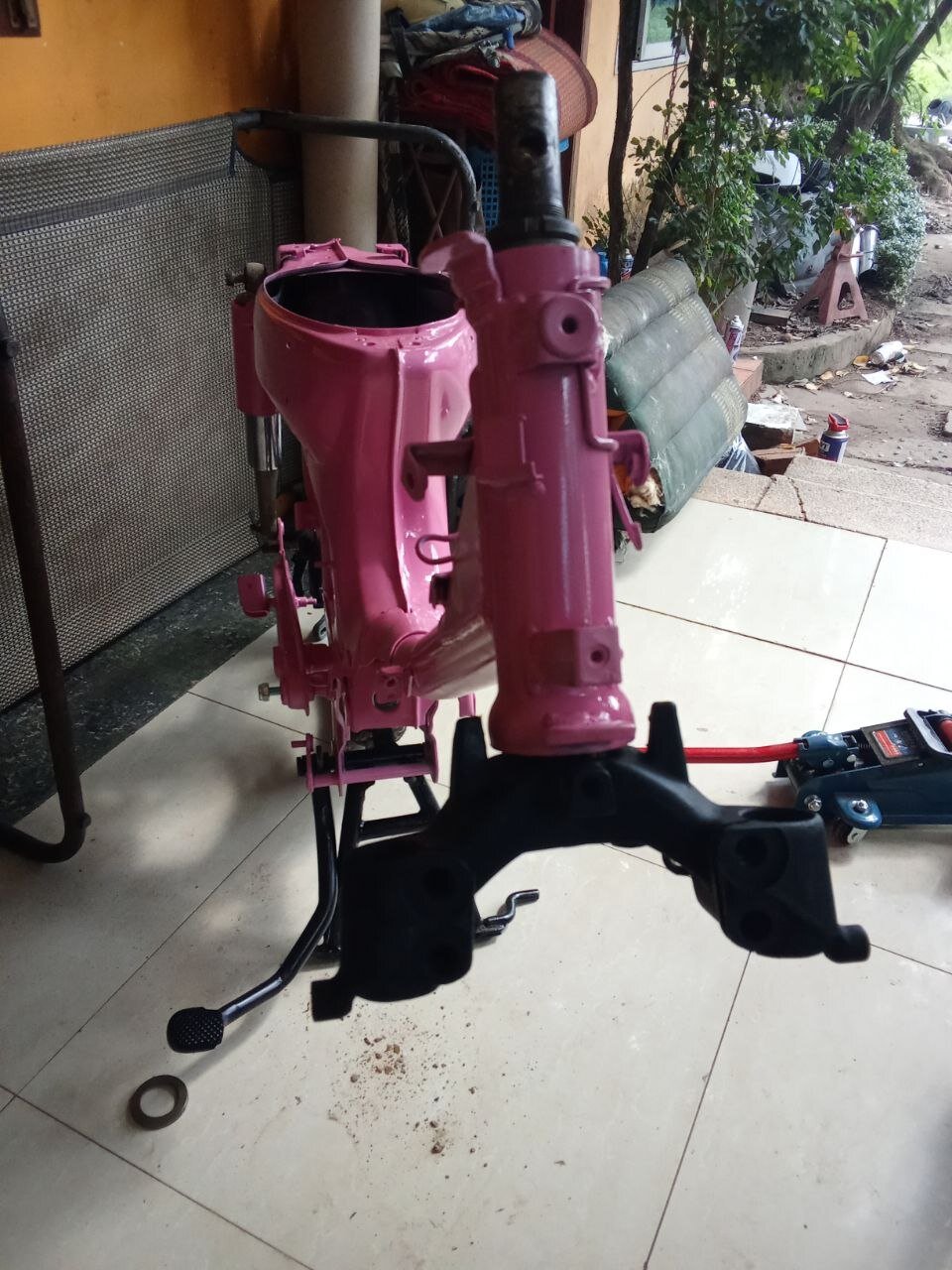

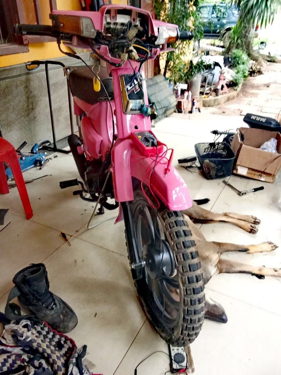

painted parts came back today, slapped some new neck and wheel bearings and cushion rubbers onto the chassis and began reassembly, wiring and engine first
tomorrow I would like to finish the wiring install, carry out headlight AC to DC conversion, install an LED headlight kit, install the fuel system, new plug, new oil, new air filter, fit chain, rear subframe and all body plastics and seat, also need to source some new elec parts locally
and need to remove front wheel and forks quickly too as I forgot the fit the dust caps to them today
would be nice to test ride and deliver by end of working week

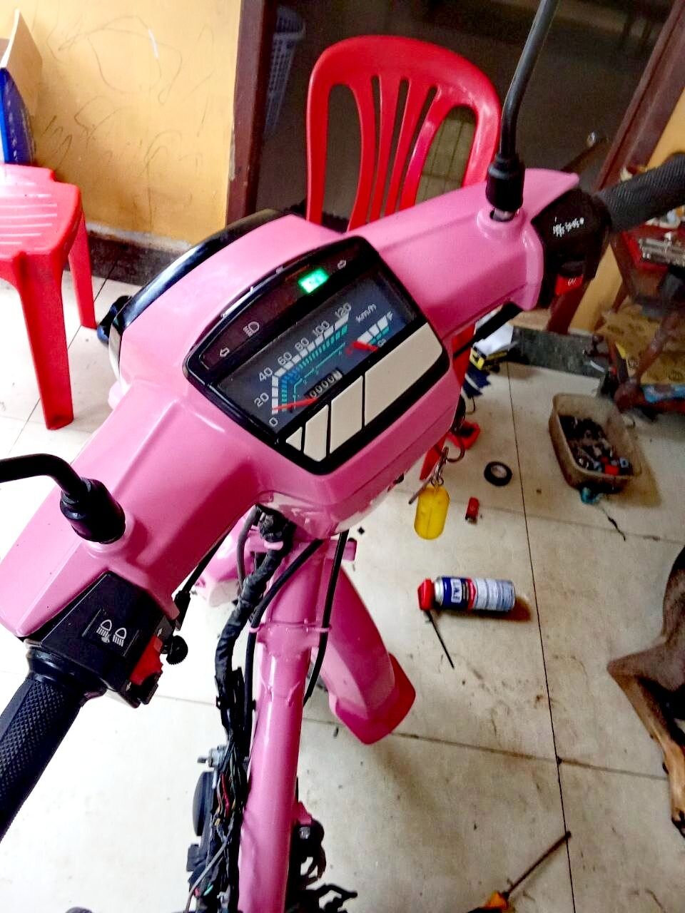

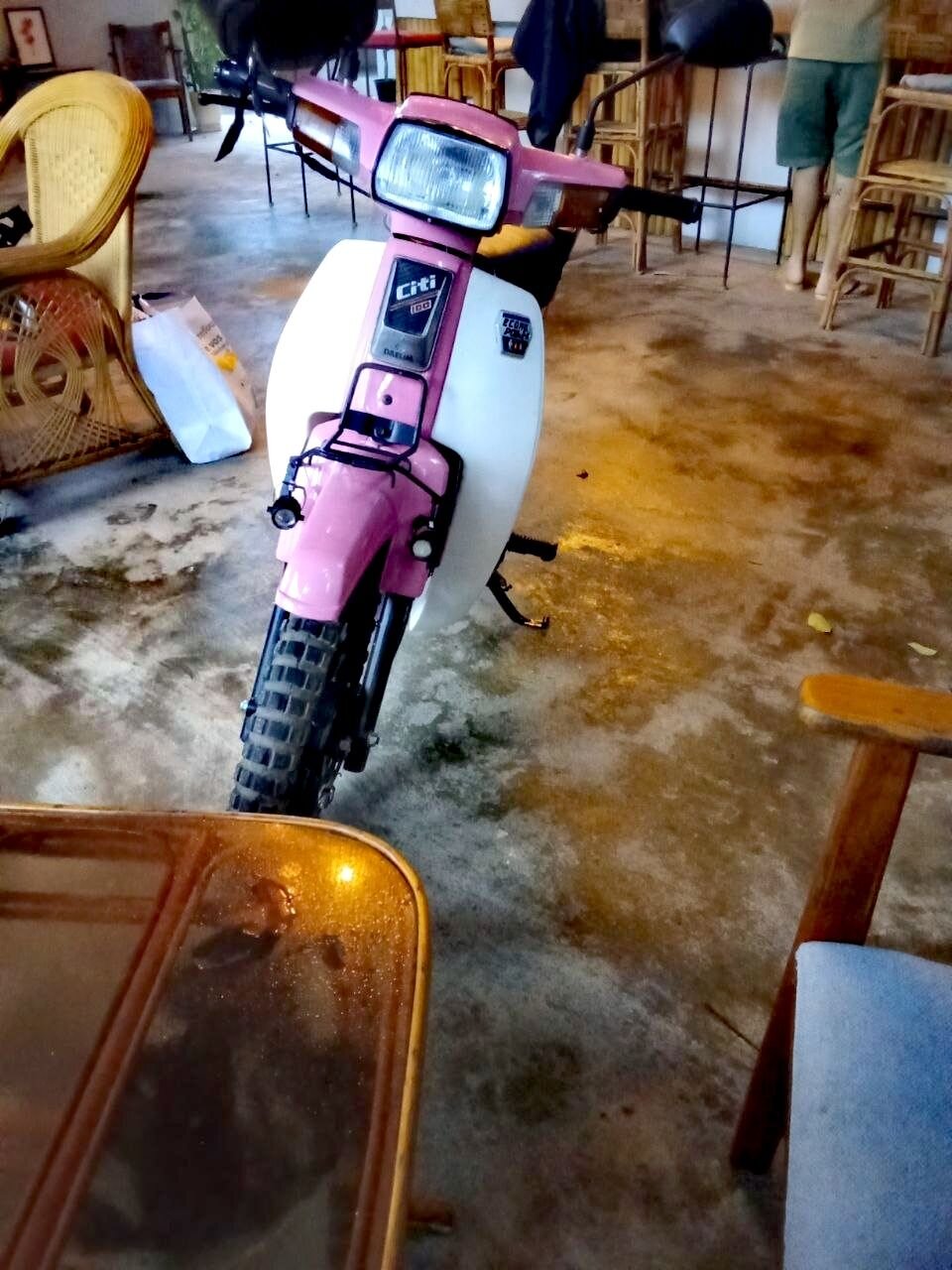

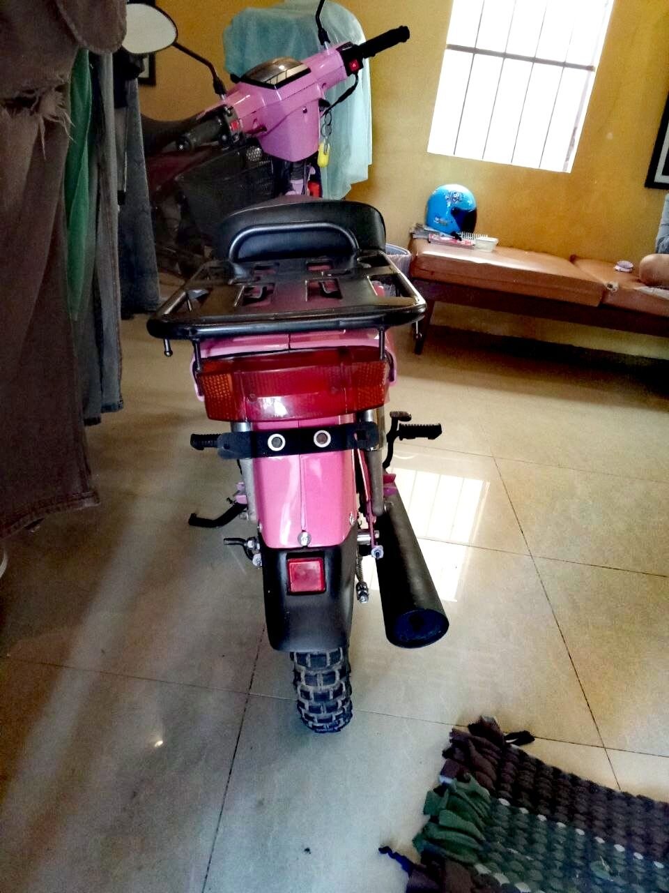

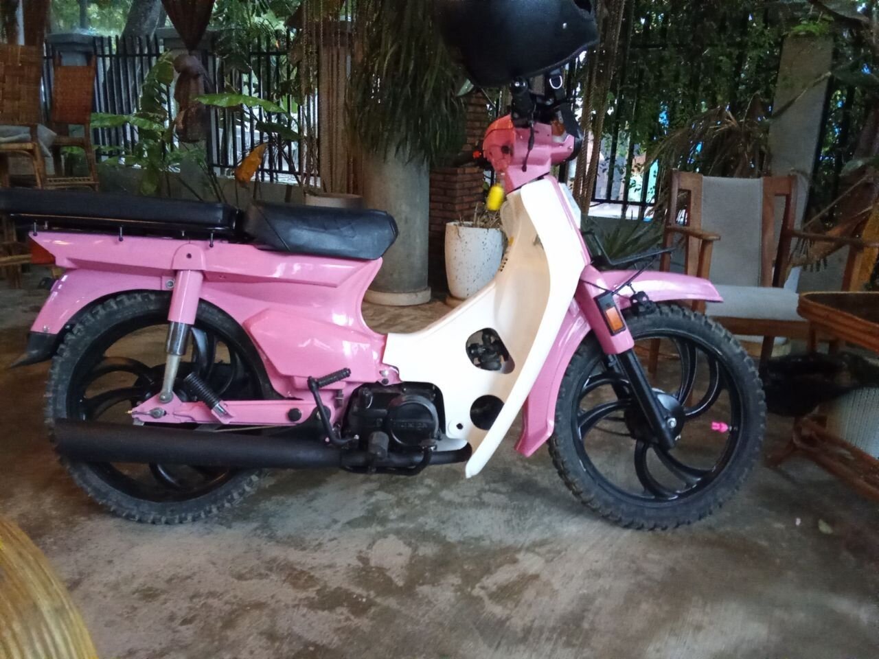

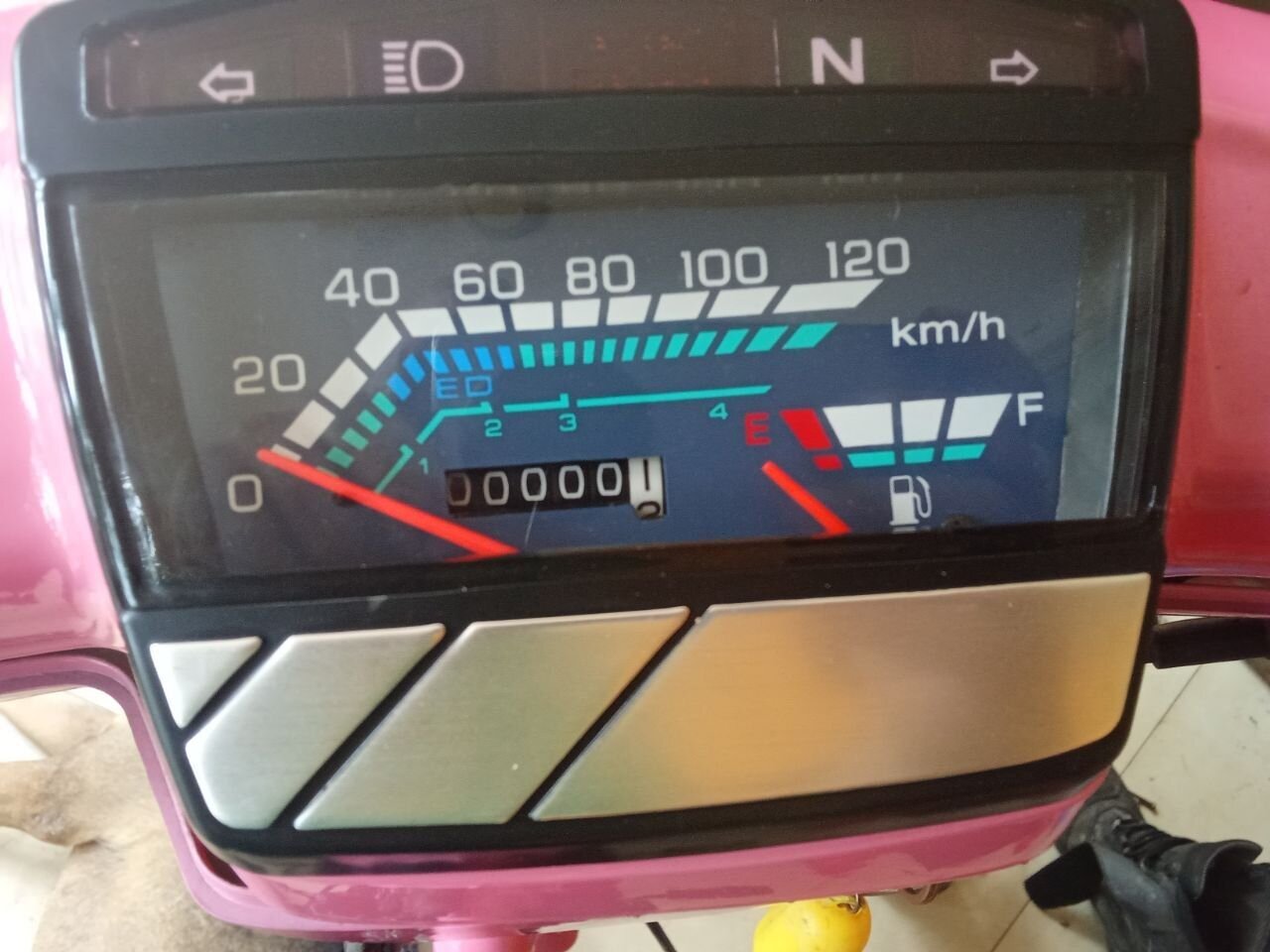

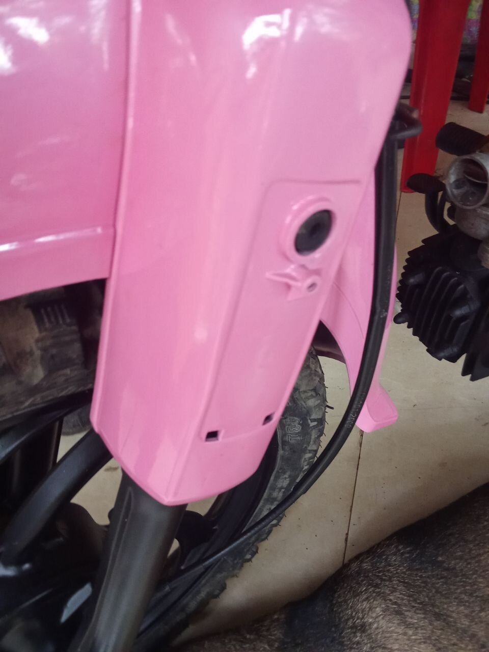

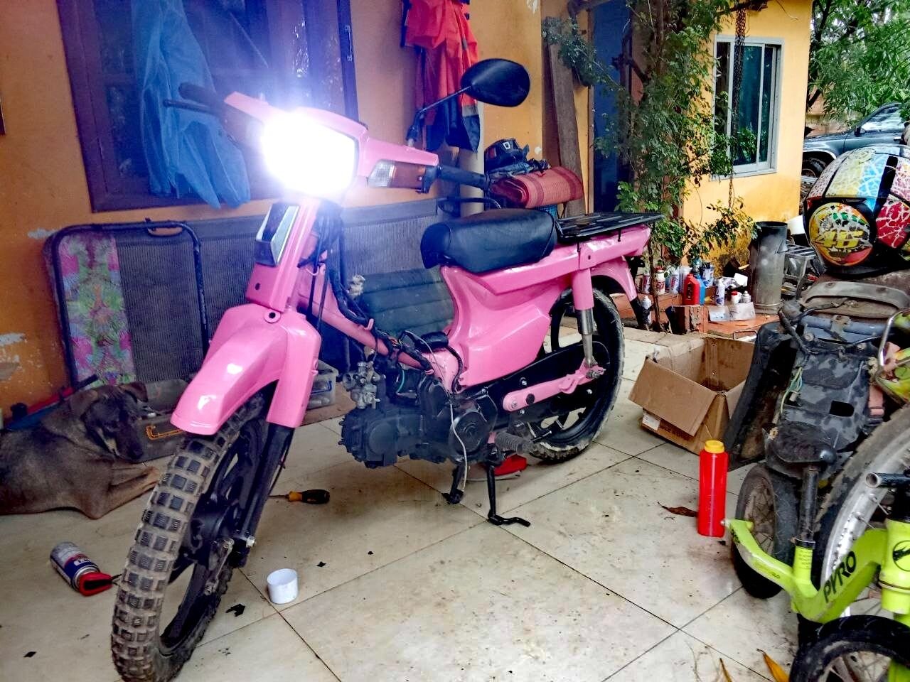

I finished this little bike over the weekend gone; took a little longer than I would have likes; wiring was a birds nest of speaker wire and mismatched colours
Customer is happy; it's exactly what she had requested
and basically done. waiting on a new white splashguard and a set of pink pillion footpegs to arrive
parts changed are: Frame Korea secondhand, Swingarm rear, spark plug, Fuel line, Fuel filter, Speedometer + cable, Handlebar switches/controls, Front turn signals, Side reflectors, Throttle cable, Steering neck bearings set, Front wheel bearings, Front and rear brake shoes, handgrips, rear wheel chain hub cush rubber, carb to airbox rubber boot, White splashguard, taillight assembly, Headlamp lens assembly, LED headlamp conversion kit, LED spots three way SPDT switch, Fuel tank cap, Fuel level sender, starter motor wiring harness, many bolts, nuts fasteners, primer, flat black and clearcoat spray paint and sandpaper/tape, front and rear axle spacers, Rear brake linkage, Wheel hub bearing seals, Paintshop for frame and pink panels,, fork seal dust caps, swingarm bolt and axles and probably some small stuff I won't remember until after I have made and issued the bill. . .
probably 30h work, billing for 18 hours plus parts + premium as customer is a mate
this is the AI template I was asked to follow by the customer
except she specified no stickers and engine and headlamp surround also black
except for  the splashguard which isn't here yet I think we pretty much nailed it
Fin
