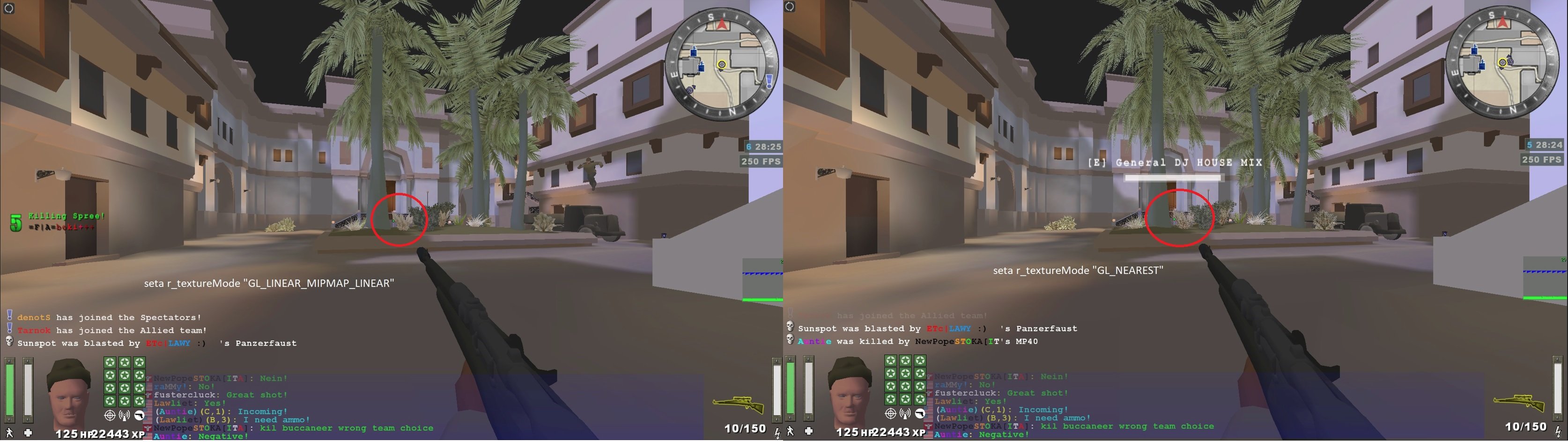

Hello
Thank you for your effort.  I can see that you have ran the timedemo in ETLegacy client, but in your config there are a lot of commands, that are 2.60b specific and do not exist in ETlegacy. For example:
seta r_ext_NV_fog_dist "0"
seta r_nv_fogdist_mode "GL_EYE_RADIAL_NV"
seta r_ati_fsaa_samples "0"
seta r_smp
seta r_vertexLight
r_lowMemTextureSize
r_picmip2
etc...
Just type these in your Legacy client and press tab, to see if the engine recognizes the command.
And few pointers more:

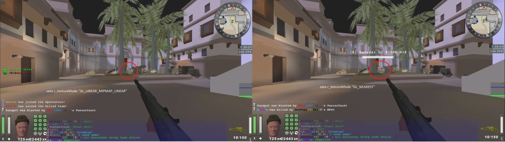

seta r_texturemode "GL_NEAREST" is the lowest/fastest textrure mode (not GL_LINEAR)
You should add:
s_mixPreStep "0.02"
s_mixahead "0.06"
cg_descriptiveText "0"
r_fastsky 1
seta cg_impactparticles "0"
seta cg_showblood "0"
seta cg_markTime "0"
seta cg_bloodDamageBlend "0"
seta cg_bloodFlash "0"
seta cg_bloodFlashTime "0"
seta cg_bloodTime "0"
seta cg_atmosphericEffects "0"

So, these can be removed from an ETL CFG, is what you're saying??
What do you mean by etc?? What else can go from a 2.60b to ETL CFG?
And my texture mnode reads seta ui_r_texturemode "GL_LINEAR_MIPMAP_NEAREST"
Also, I have/had
seta s_mixahead "0.05"
s_mixahead "0.02"
seta cg_impactparticles "1"
seta cg_marktime "2000"
Edited by -=HipKat=-
Yes, all the commands I listed can be removed from Legacy cfg, because they dont exist in legacy client/engine. I put etc.. because there are probably more commands that can be removed, I did just a quick scan through his cfg. All you need to do is type the beginning of the command in legacy console and press tab, and you will see what command is supported and what is not.
I havn't tested it very thoroughly, but If you have cg_wolfparticles 0, it wont have any affect. Cg_wolfparticles controls if damaged vehicles emit smoke or not.
I use 500 myself. Its sets the time (in ms) for how long impact markers (bullet holes, mortar marks) are visible. Setting it anything besides "0"  will reduce your fps a little, but it can also be useful info. Like you will see where mortar shells have landed, so you know to avoid that place. Just test it out, but I think 2000 is a bit too long, with no real benefit.
This only sets the texturemode of your user interface (game menus, etc) and not the game graphics itself. For game graphics you need to use r_texturemode. I myself use the highest quality (GL_LINEAR_MIPMAP_LINEAR) and medium (GL_LINEAR_MIPMAP_NEAREST) is also ok. I do not however recommend using the lowest value (GL_LINEAR). Even tho, you will get marginal fps boost, but believe it or not, it will make the foliage thicker.
Edited by HarryAimpotter
Thanks. I prefer the highest graphics, also. I play to enjoy the game, not be some super scrim player
But dude, a CFG has hundreds of lines. Who's going to test each one in game?? lol

8 hours ago, HarryAimpotter said:
Hello
seta r_smp
seta r_vertexLight
r_lowMemTextureSize
r_picmip2
etc...
You should add:
s_mixPreStep "0.02"
s_mixahead "0.06"
r_fastsky 1
The settings you tell me to add I already have in my personal cfg, but these 2 cfgs are concise and only include commands for testing the timedemo. I haven't created a complex cfg as if I were going to use it for playing. If you want to see mine and you're interested, I can attach it to you.
