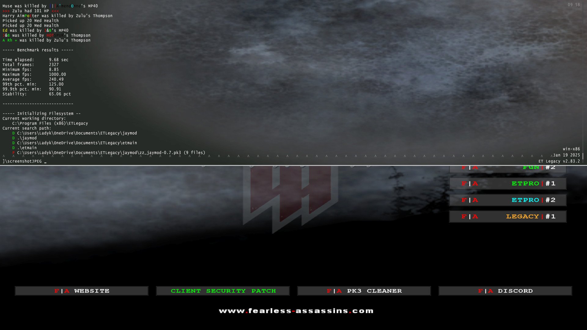

Download demo (it.dm_84)
Put it in ETLegacy\jaymod\demos folder
Launch game in jaymod
In console type \timedemo 1
and then \demo it
After demo is played open console (scroll up a bit) and post average fps. I got 450.
it.dm_84

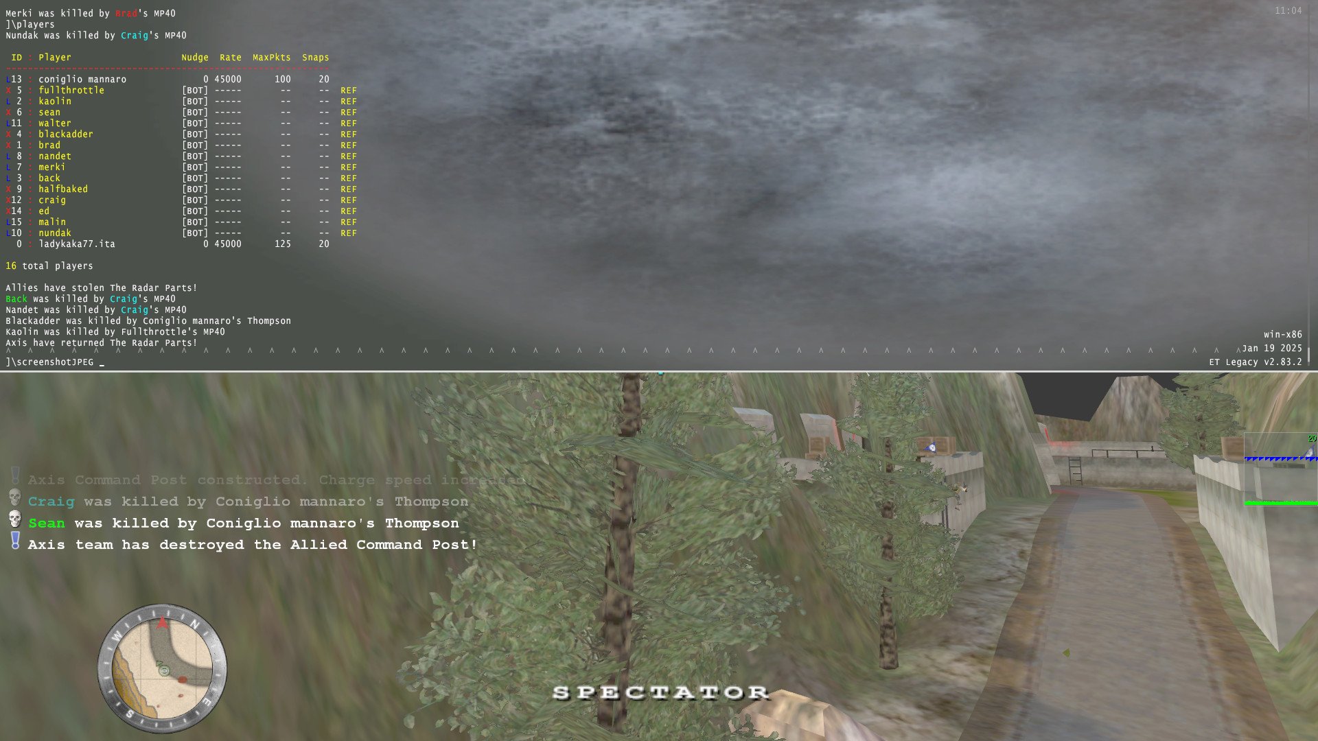

In the context of ET: Legacy (the client and server for the Wolfenstein: Enemy Territory game), the command /cl_maxpacketscontrols how often your client sends data update packets (your actions, movement, etc.) to the server .
The difference between /cl_maxpackets 125and /cl_maxpackets 100is as follows:
SettingDescriptionImpact on the Game
/cl_maxpackets 125Sends a maximum of 125 data packets per second (PPS) to the server .Smoother/more responsive action. Your actions are recorded by the server 25 times more per second than the 100 setting, providing a more precise and responsive gaming experience. This is the ideal setting for those with a good connection.
/cl_maxpackets 100Sends a maximum of 100 data packets per second (PPS) to the server .Less responsive than 125. This is the all-time high of the original Wolfenstein: Enemy Territory .
Technical Details
Responsiveness: The increase from 100 to 125 packets per second means there's less latency between when you perform an action on your computer and when the server learns about it. This translates into perceived smoother movement and greater precision in actions like shooting or jumping.
Official Limit: The cvar cl_maxpackets typically ranges from 15 to 125 in ET: Legacy. While the limit was 100 in the original game, 125 is the recommended maximum limit for players with broadband connections.
Bandwidth: Increasing the number of packets sent increases your upload bandwidth usage . A value that is too high (beyond your connection's capabilities) or not supported by the server can cause increased ping and, paradoxically, worsen the game. Generally, 125 is a safe value for modern connections.
Basically, if your connection supports it, setting it /cl_maxpackets 125is preferable for greater smoothness and accuracy of gameplay.
\cl_maxpackets 125
\players
