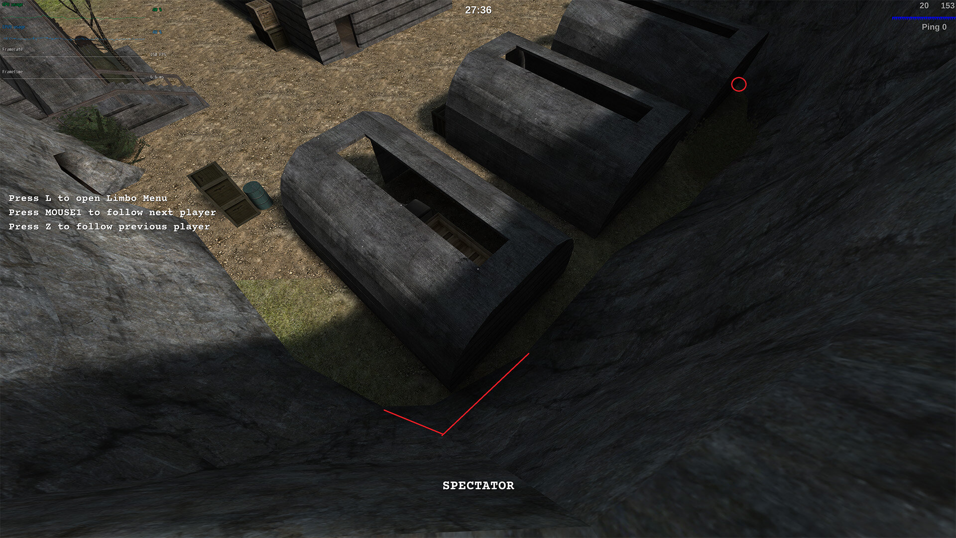

On 7/5/2025 at 11:30 AM, uips said:
If u want players to be able to go around those hangars, could give a little bit more room at red circle. Or if u do not want players going behind those you could move the mountain to green line
Still coming back to those ? Fun to play around them and important part for Allies to get control over the area too. Just the sides are too narrow. Can not move properly or open corners efficiently. Allies side is the worse as u are forced into airtime to get past it. (and opening corner while being in airtime is something u never want to do in this game :D) Axis side little bit better ;) Basically the corner areas of the Hangars get a little bit too tight

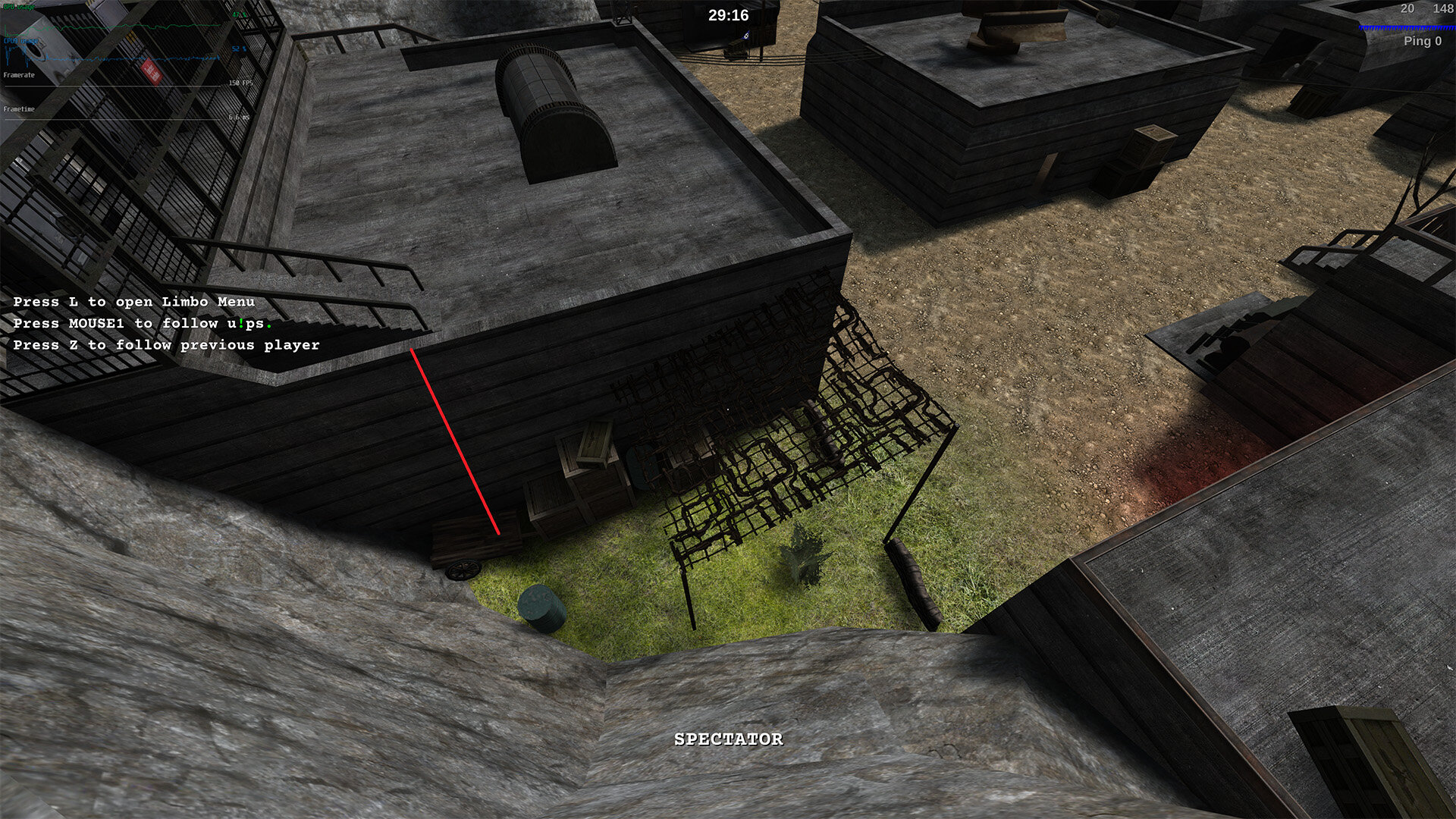

Ladder would be ok here to let Allies get up quicker instead of multiple jumps over those grates? This building upper area seems esstial for Allies as well to get control over whole area better (And the  top of middle building)

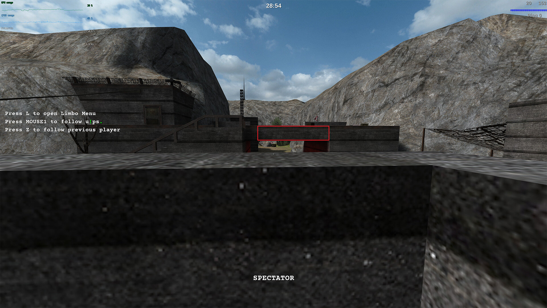

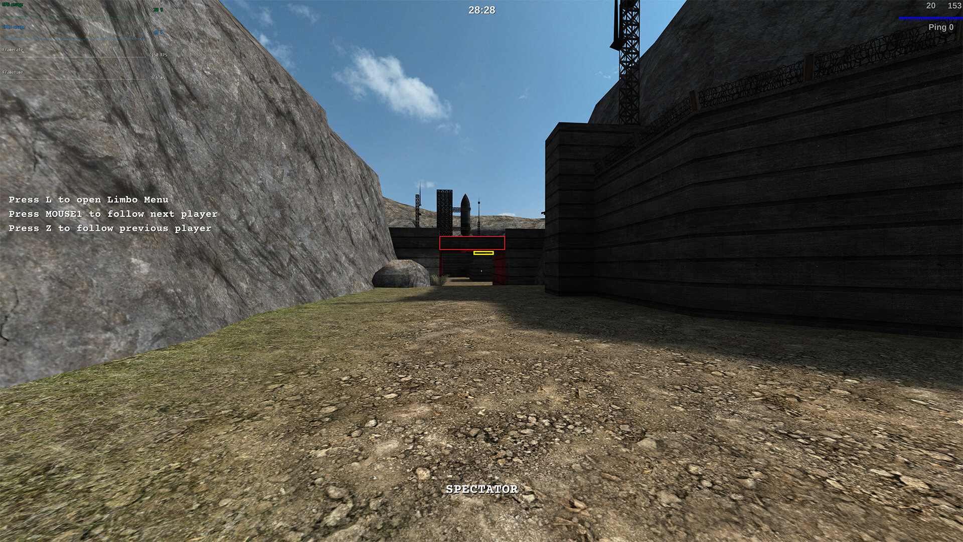

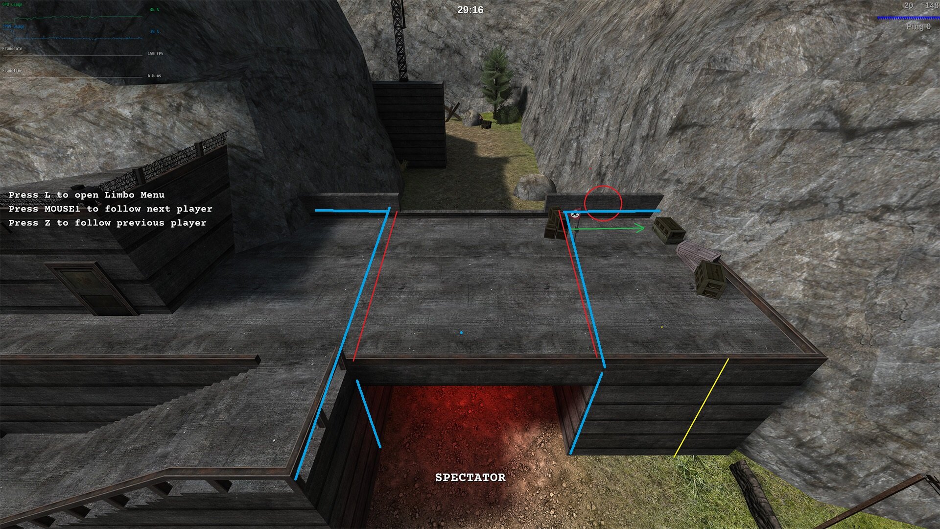

Top of Axis middle building combined with the front wall is op place to shred Allies who run into base like a sheep. From Allies side there is very tiny opening to see the Axis. And from Axis side they can see exactly what they need to see.
Allies view:
Axis view:
Edited by uips
I would suggest to get rid of the mid part and from more view from both sides. One side has stairs already. Could add ladder to other side to give accees. Also can move the MG to one side and not actually use the constructible MG, but the one that is repairable. Those are in use in maps like et_beach and battery for example. This way u get rid of crates that can take room and limit area.

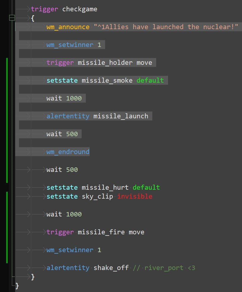

spawntimes are set by server and not by me i just added random spawntimes in mapscript. any guy with access to mapscripts can edit and change spawntimes.
wm_axis_respawntime 8 //original 30
wm_allied_respawntime 6 //original 20
and indeed i always test my maps with beg2 settings - mainly with doublejump 😄

- Since you tested it with double jump, on servers that don't have double jump or long spawn times, the truck can make it pretty far without the option of axis doing damage.  My recommendation is the axis second spawn is the forward post next to the water (by a CP) and move the barrier up to right after the truck crosses the bridge.  Once the truck moves past the barrier, the axis default spawn goes back to the final spawn as it is now.  If you do this, I suggest moving the truck barrier up some close to the axis base maybe halfway between where it is and the bridge area shown in the screen shot above
