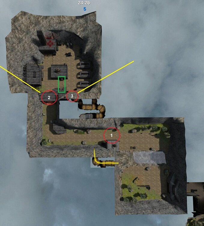

imo Nuclear Delivery could easily be separate map from Special Delivery. It has enough content to be standalone map and it is always easier to keep smaller maps balanced. If u want to play the SD you could just play that map. Jump straight into new content of Nuclear Delivery without having to play the SD part to get there.
Map is fun indeed but has quite many choke points (That might vary on server settings and amount of players)
First tunnel is quite long. More than 10 secs of just running of Allies. That whole part could be skipped and it opens up from truck part directly to the bridge area.
I see the ND part working well as 2 stages with capturable flag bunker in middle. (That gets secured at some point when Allies advance more)

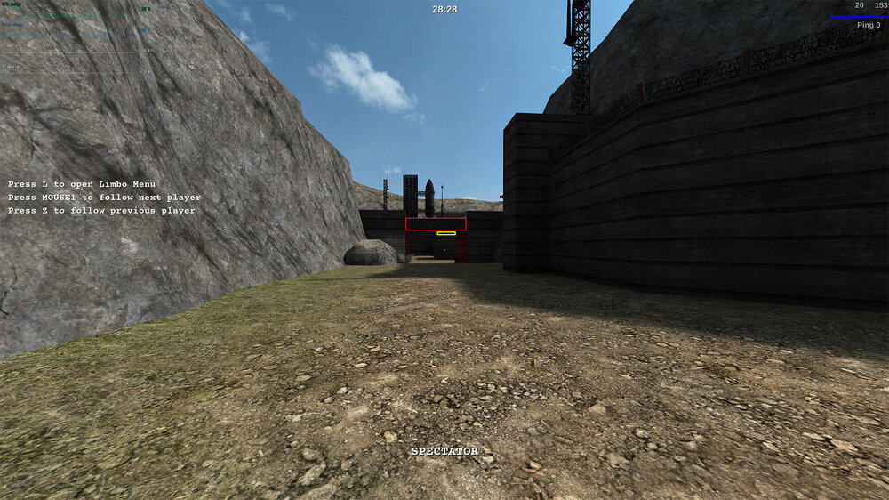

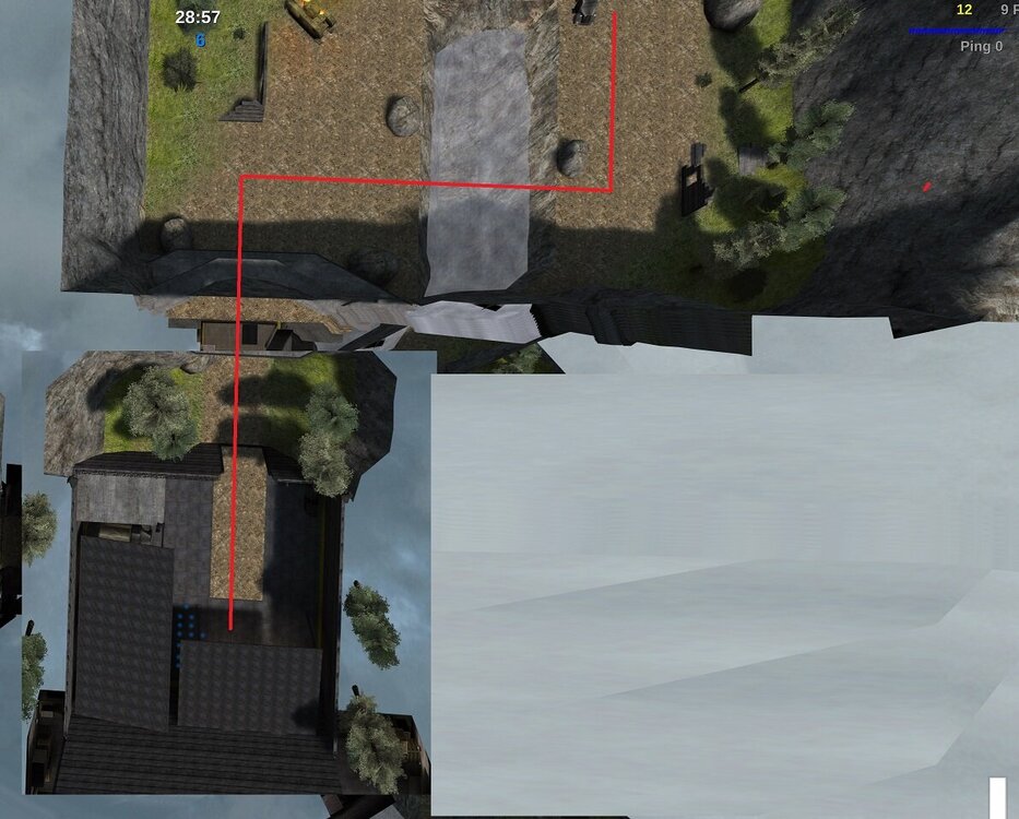

Circles 1, 2 and 3 seem to be choke points and can get hard to pass. So maybe additional tunnel near 1 (Middle bunker) so Allies have more than one way to go. (Else Axis just need to spam 1 way to stop Allies) Just made a quick possible concept on image
2 is another hard part to pass for Allies because it opens up to quite big open Area where Axis could be anywhere shooting. Similar case with 3. I The green box is a concept of some kind of wall or blockage to prevent Axis seeing both ways all the time. That might make Axis think more which way to defend than camp both entrances at the same time.

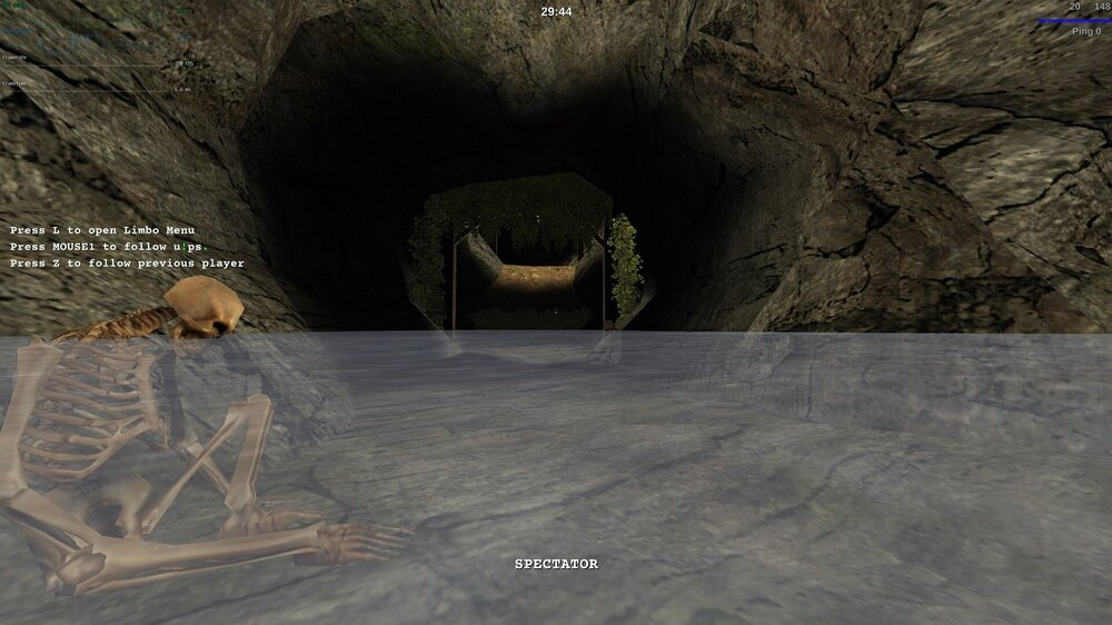

Water Level in tunnel should be lowered more. Right now if u crouch in that water u enter swimming and that affects shooting poorly. Lowering Water level more will fix this.

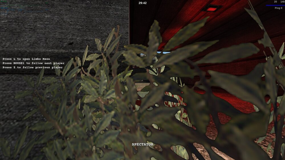

This bush prevents Allies from using one side of the entrance effectively as it prevents seeing enemy correctly

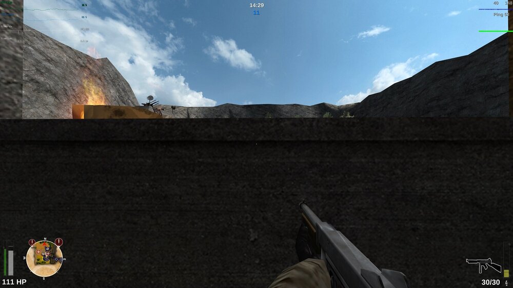

Could lower this wall more so crouch shooting from here can be effective

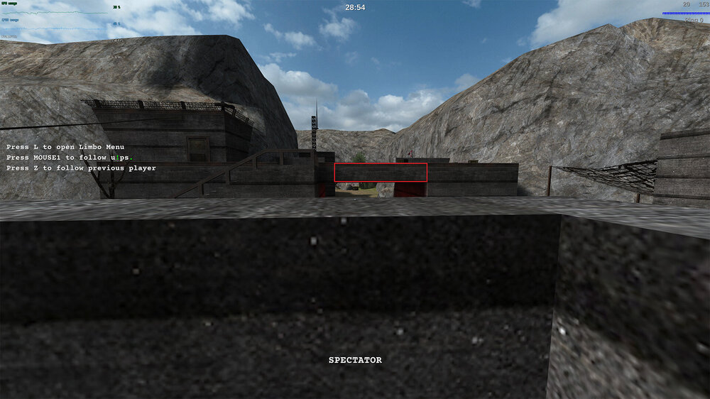

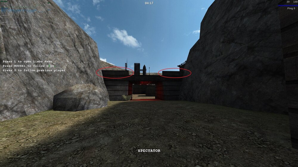

Also lowering those upper walls more will Make it easier for Allies to shoot Axis up here (Right now u can barely see head)
Edited by uips
thanks for your feedback @uips
almost everything u said above is already on my mind for the final version of this map.
to be honest , before making this map i couldnt really make a map from scratch so i needed special delivery base pk3. thus i had to somehow make my edition of the map as a next stage :)
i wouldnt agree with capturable spawn flag in the bunker because its really close to the command post so it would be useless and/or make it so easy for the attackers to reach the command post when flag is captured.
9 hours ago, uips said:
those chokepoints are bad indeed, i like the idea of the green wall/blockage suggested here.
the route/tunnel you suggested there with the yellow line is definitely needed.
and by the way, i wouldnt like to play this map on non-doublejump servers :(

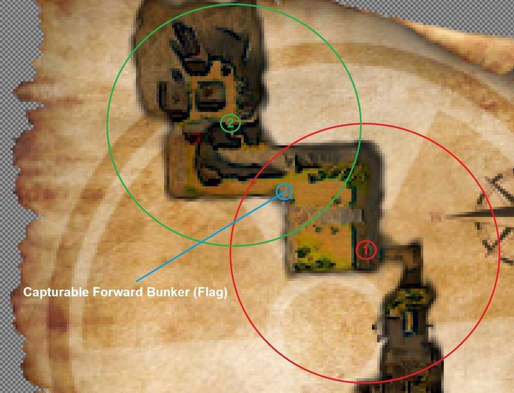

Map is actually quite fun (talking about the ND part here). If manage to solve the balance issues, the ma can be quite enjoyable to play. Maybe do not close the case with next version being final ;)? Leave it open for changes, Might want to revisit and improve in 6 months or year if gather ideas.
Flag in middle made it possible to advance for Allies. Just reaching the CP was even harder. Also it s quite playable in non-doublejump server too ;)

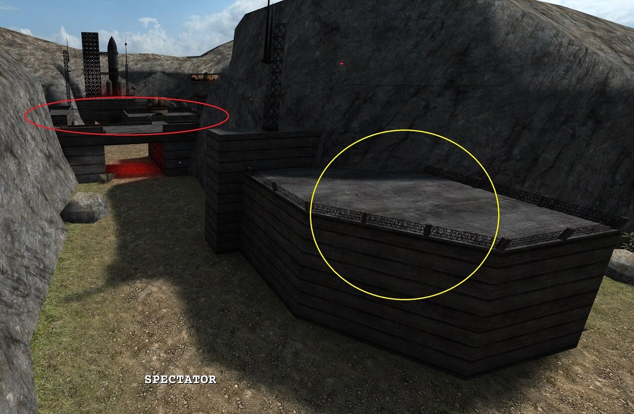

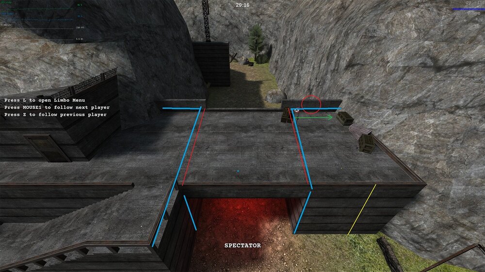

Someone suggested in that gameplay video to give access to CP bunker roof. This could give more attacking power to Allies and chance to get better control of higher areas.8.thumb.jpg.13f0a6243259f18b38589dfe360bc480.jpg
If u want players to be able to go around those hangars, could give a little bit more room at red circle. Or if u do not want players going behind those you could move the mountain to green line

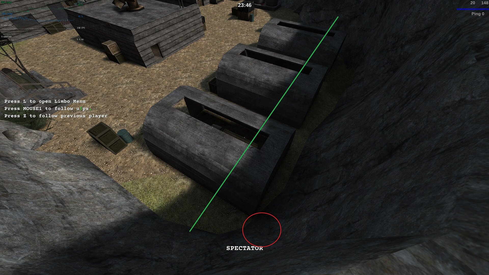

too bad ET limits my capibilities :( i blocked that area to keep map performance for players. no can do.
and this area is intentionally narrow :)

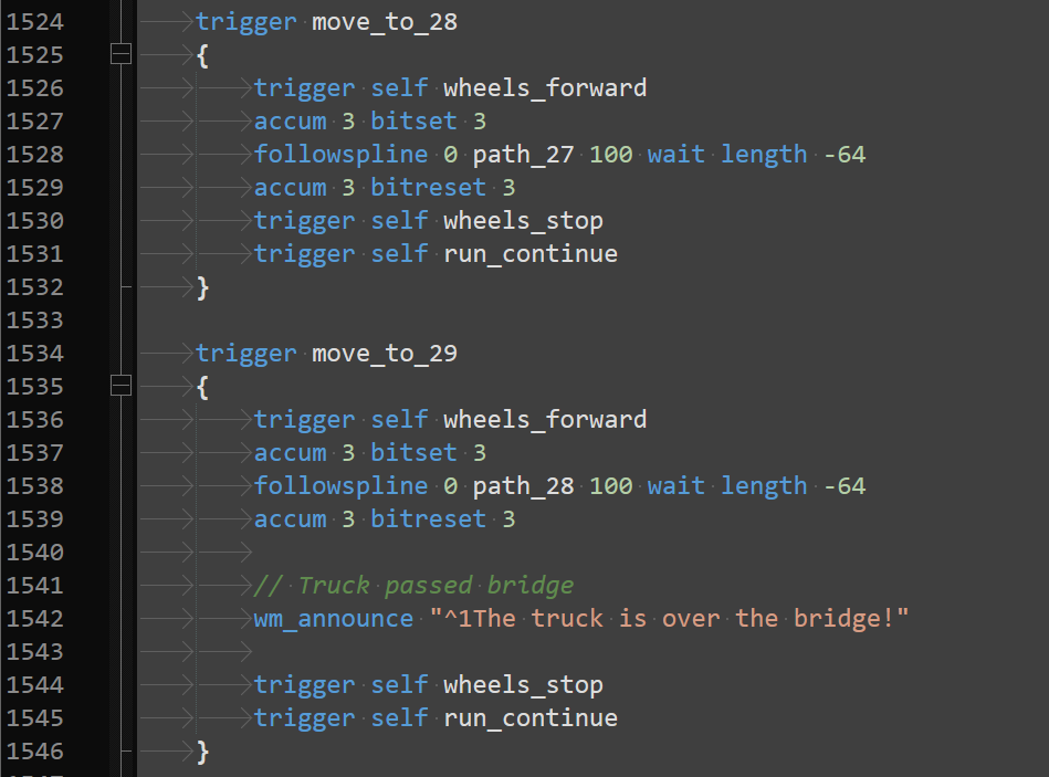

i think the announce should happen on move_to_28 as this is the last one after bridge. Right now if truck gets destroyed and stops after crossing bridge, there will be no announce until someone moves the truck one spline further

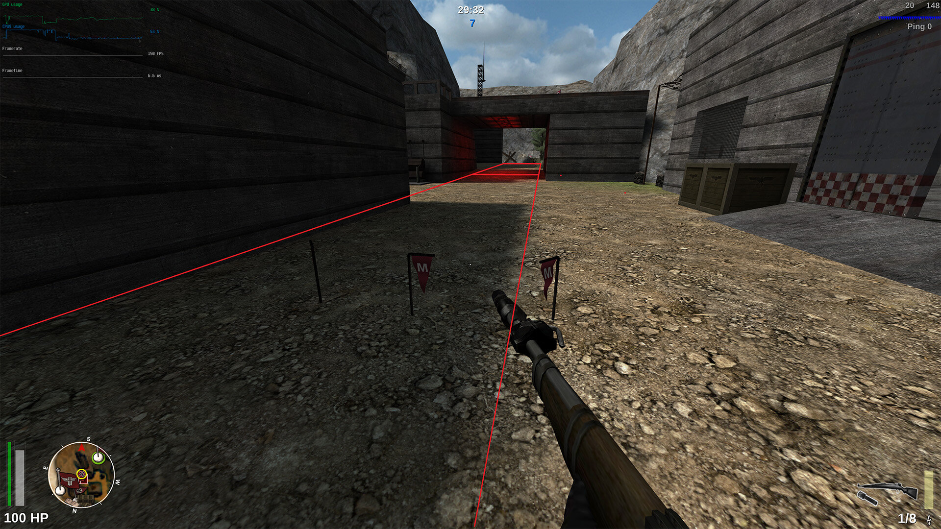

Could add some harder surface road into base area to prevent planting landmines in front of the truck. Axis can limit movement of truck to 1 spline by planting enough landmines in front of it. Basically damaging it as soon as it starts moving. This is probably the reason why planting landmines was disabled in bremen truckmod.10.thumb.jpg.4c8a8d1ada51e5c4d83b824d10607f08.jpg
