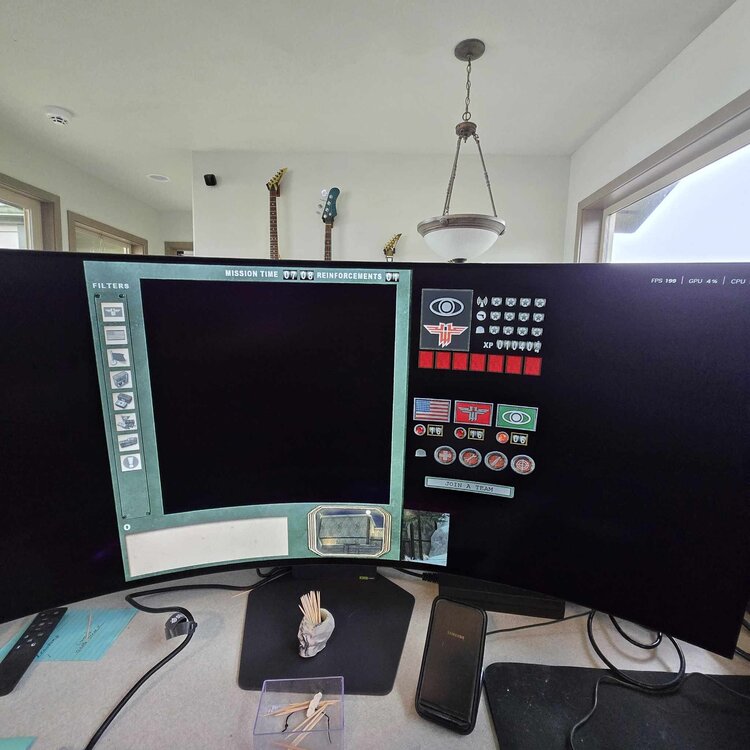

I just got the new LG 45 5120x2160.  I changed my Custom Height's and Width's.  It works fine on Jaymod, and NQ,  But in Silent when I hit L for the limbo menu I can't join a team the menu is Kinda blacked out.  no mouse pointer and boxes missing.  So I can't join a team.  Here is the pic of the Limbo screen.  Again both Jaymod and NQ work perfectly.  I can watch people do functions Type in main when not pressing the limbo "L"  Please help the old Man SUCK IT!!!!!!!!!!!!!!
I wonder if thats screen wrap.  Can you open console in that server and do print r_customwidth and print r_customheight and show me what console says?
