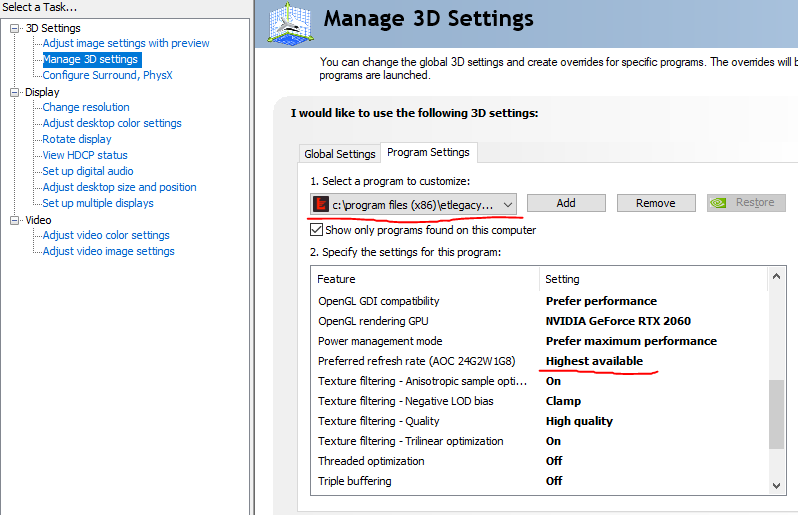

have a 240hz monitor in desktop 240hz in game 200hz or sometimes 180-190hz why does anyone know maybe use dp cable in nvdia settings is also on 240hz ?
Turn of V-sync and/or g-sync in monitor settings. You get less hz in game because your monitor tries to match your hz to your ingame fps. Also make sure you have r_displayrefresh 240
Maybe lowering the screen resolution can increase fps. Lowering the resolution will surely give you a smoother game (I play with 1024 x 768), and you will be able to play with more stable fps and with the hertz that the screen gives you. You should check some things too:
Sometimes monitors with 240 hz are only prepared for freesync.
1) Does your monitor have the "Nvidia Gsync" logo? If so, you can help yourself with the cfg nvidia program to play;

That means gsync/vsync of freesync is still on. You need to turn it off from monitor menu (freesync) and also in nvidia settings.
Edited by HarryAimpotter
But in NVDIA settings and in monitor is already off I can't play with 200fps 240 Hz?
I made 200Hz in the game and I tested Freesync deactivated with 240fps stays at 200Hz try with your setting not works
My GPU is NVDIA and monitor is Freesnyc Premium Pro
I need to enable gsync compatibility or ? Otherwise only at 200 Hz somehow
NVDIA settings I have to activate gsync and in the game 240fps then it works monitor shows me then 240Hz bad setting really Have to live with it xd but thank you very much ?
