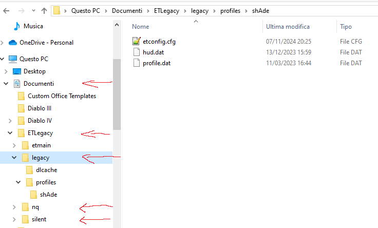

Hi there,
i assume you're using ETLegacy client 32 bit, if not this is the better version of the client to play the game
(if you're using the old 2.60b client than all the files will be under C:\Program Files (x86)\Wolfenstein - Enemy Territory\.... )
In the Documents folder (in windows) there should be an ETLegacy folder containing all the needed for the game
inside this folder thare are the mod folders (legacy , nq , silent etc..)
inside each of these there are the "profiles" folder" then the single profile and finally the etconfig.cfg
Each of these etconfig.cfg files are safe to delete if you are using a separate config to loadup when you start the game
If not using a separate config file to load up then don't delete them .
Check each of those etconfig.cfg and look for typos in the "name" cvar,
the correct spell is like this:
seta name "^0=F^/|^wA=Lar^2r^hY^7"
(the double quote is needed at the begining and end of the name , not allowed in the middle)
Since the only change you made is in the name i point the finger to some typo in some cfg file that gets loaded
