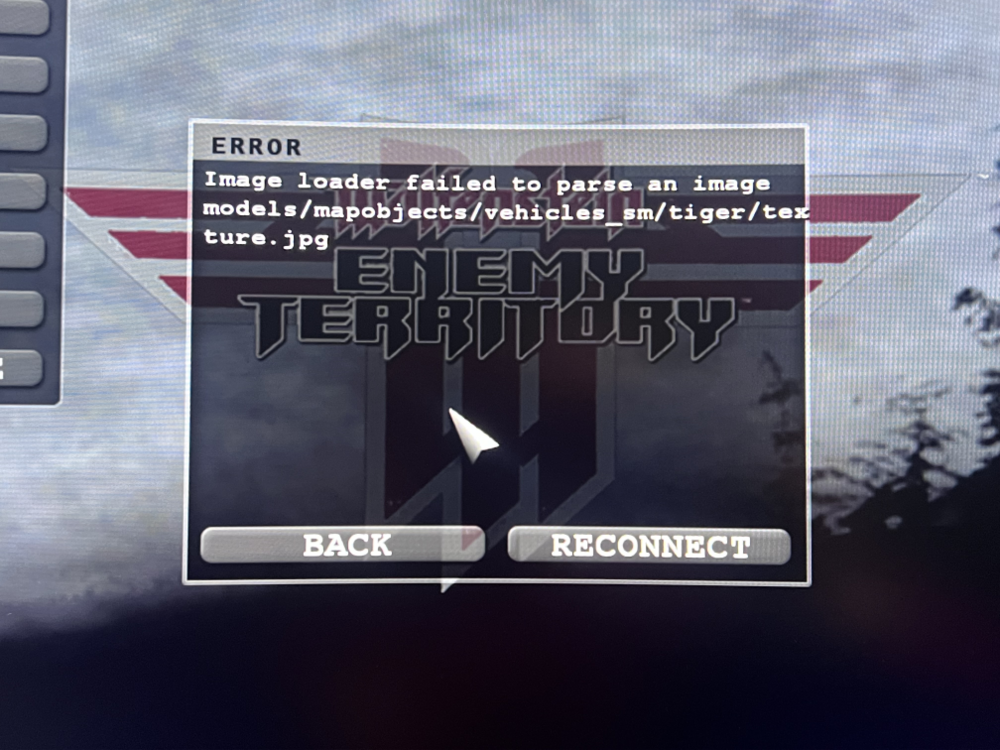

So, I've had to reinstall ET 3 times in 2 days, it's getting super frustrating.  The bad surface type saga continues.
This time I did a condump of the error:
4445 files in pk3 files
ERROR: Bad surfaceType
Sys_LoadGameDll -> FS_CL_ExtractFromPakFile(C:\Users\ameli\OneDrive\Documents\ETLegacy, jaymod, ui_mp_x86.dll)

I'm wondering if it's a setting I'm using. Please help!!

Ah yea @RedBaird reminds me. Kinda useless at the current moment but another person, zeezuss had major fps issues , found out his entire game was being loaded via one drive. He made it point to his regular HD and worked fine afterwards
How do I change that?? Anyone want to remote into my computer, lol

Just go into your one drive and go into settings and in there you should see either auto backup or sync can turn them off if you don’t care to use it at all. But there should be a spot to exclude et all together. Just remember to copy your guid and such over to your hd before or you’ll end up with a new one
I thought I did that, I’m so confused.
I checked my one drive thing, disabled one drive, reinstalled my entire PC and said NO to onedrive.... it STILL gave me one drive folders.  Then, I tried downloading ET fresh again, and my PC said No thanks, there's not enough memory.  I am about to throw this overpriced lit up piece of crap in the firepit.
How about Settings > System > Storage > Where New Content Is Saved?
All of the options on this screen should be set to one of your local drives instead of OneDrive.

Its all set it HD
So, after reinstalling your PC, do you mean like a full reformat? Or did you just backup?
Have you tried the game since reinstall?
Same error?
My next suggestion would be to download a new installer of ETL, and do a another install in a separate folder on your PC (creating 2 ET's on your PC)
Don't copy over ETkey or anything and see if that works. If it does, this will tell you it's something to do with your client and not your PC. If it does not work, it's something to do with your PC and we can go from there.
Unless of course as Red said, some ETL expert pops up and knows all ?

I have successfully been connected for 2 maps now lol
