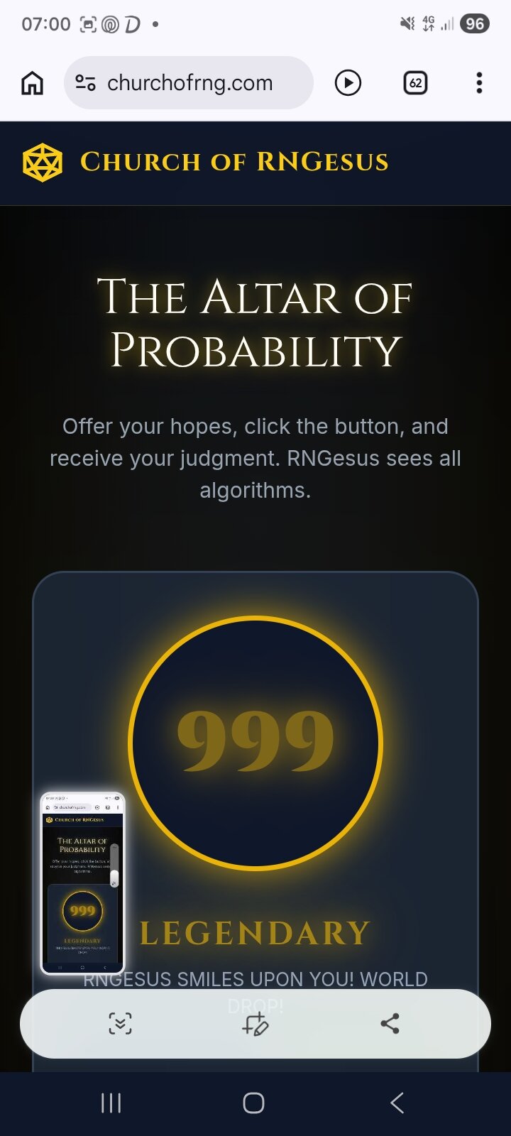

Platinum VIP Snake in the Grass Posted July 21 Platinum VIP Posted July 21 @RNGesus And thank you for giving back hope in probability : 4 Quote
Shoresy Posted July 21 Posted July 21 hahaha @RNGesus @Snake in the Grass is part of the religion now ! 😄 😄 😄 1 Quote
ET Member RNGesus Posted July 21 ET Member Posted July 21 11 minutes ago, Shoresy said: hahaha @RNGesus @Snake in the Grass is part of the religion now ! 😄 😄 😄 3 Quote
