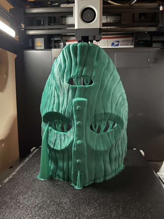

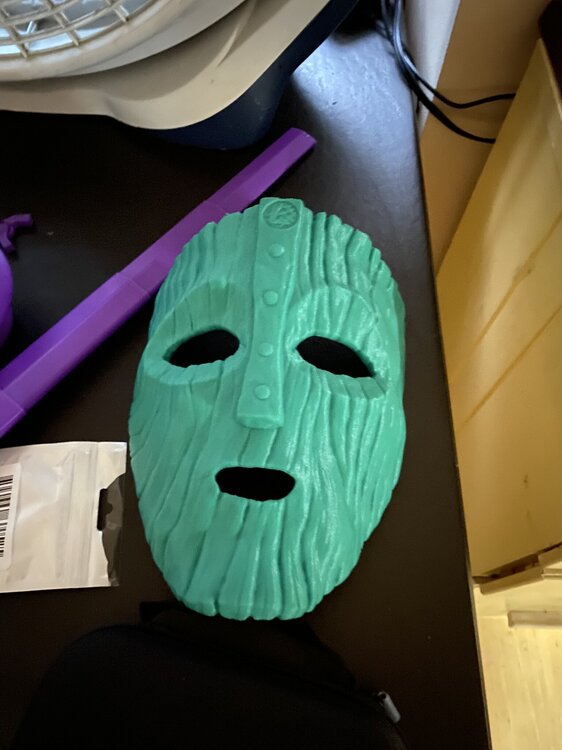

I printed The Mask this is what I will be wearing for Halloween Lol
On the printer

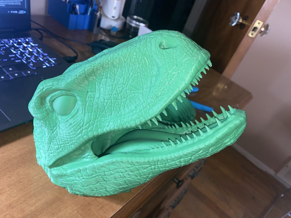

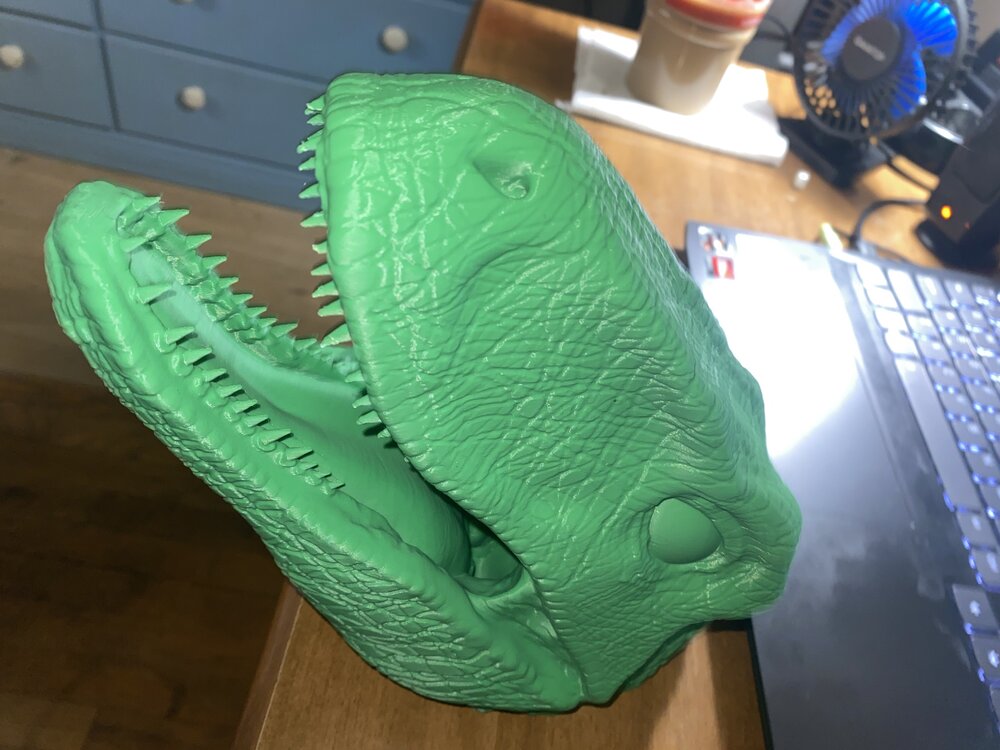

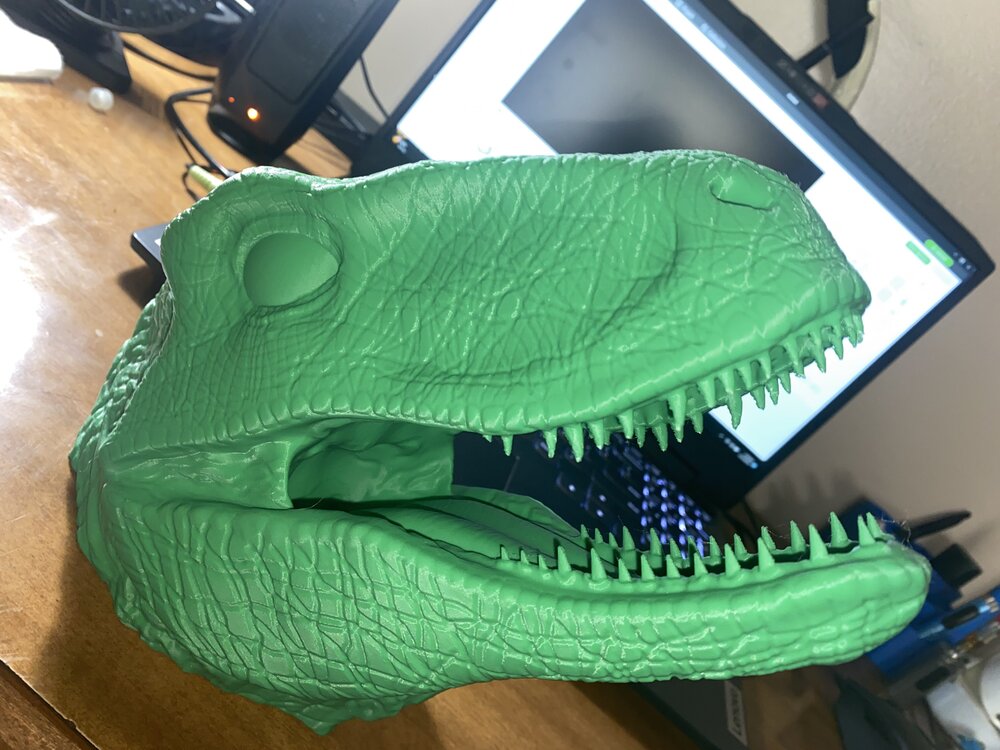

Made a T Rex Wall mount :)

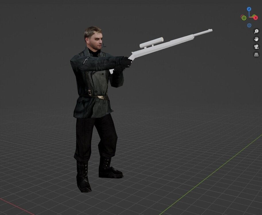

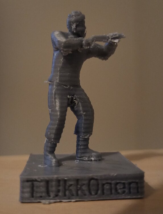

I printed this one today, if someone has any tips for proper support settings, i'm all ears ? Now the supports were hard to remove and accidentally broke the tip of the rifle, and the rough parts are where the supports were.

Regardless, I would like to point out that I love it!
For some tips, first some questions:
What type of support? (I recommend tree)
What is the distance of supports to object? (I use .08 however the higher the # the more distance so if its difficult to remove try upping this value a tad, .02 at a time I would say)
What slicer do you use? (As I have a bambulab I use bambu's slicer, but for general like Ender 3 or something, I would suggest Prusa over Cura)
Also, when it comes to printing Mini figures etc, and in fact do use Cura and a Ender printer I strongly recommend looking into this
Fat Dragon Games - Making Fantasy Fantastic
Go to recourses and choose a cura profile that is automatically adjusted to print smaller things with great detail for things like this. You will have to adjust a couple settings accordingly but overall its really cool.
