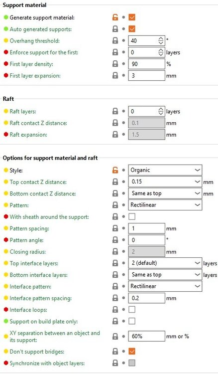

I think it's a tree support, chose organic. For the distance i'm not sure but i think if i read the configures right, it was 0.15mm. And for slicer I use Prusa Slicer, it had ready print settings for my printer, im not that good to find good settings on my own, so atleast now i have starting points from where to start tweaking.
Will look to that page, and hopefully i understand something from there.
These are my support configurations, they were automaticly like this (expect i had to manually change to organic)

Hm try doing this
Style: Normal
Interface Pattern: Zig Zag
Density: 20% (I forget what this one is called in Prusa )
The Z Distance do 0.2mm
It may or may not be better but over time you will notice you'll have to tweak settings around from time to time. Could be due to different weather conditions as I notice more complications during the winter time for me. Could be the different filaments theres just so many possibilities. Don't be too afraid to mess with settings just pay attention to what you tweak, maybe save the profile first so you can always revert back if its worse than before, then tweak something else instead ?
