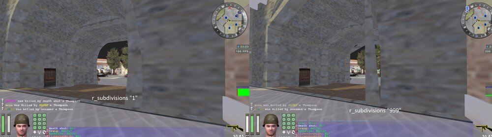

~5 fps with r_subdivisions 20 ( 999 is max)

~5 fps with r_subdivisions 20 ( 99 is max on legacy btw)

  • r_subdivisions 20 is actually max it is forced but doesnt hurt using 999

Ok, that is news to me, I have to look into it. Im not sure what is the actual max on subdivisons.
