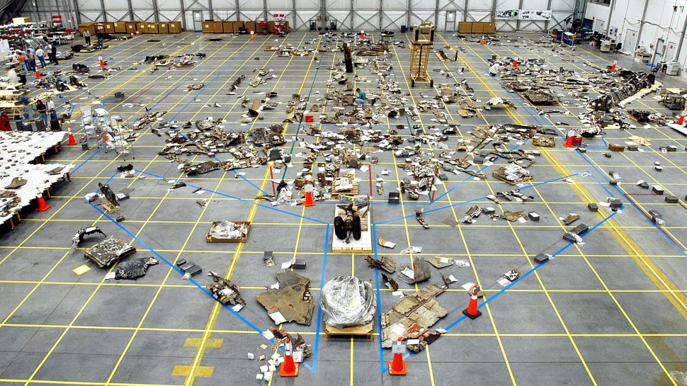

Debris from space shuttle Columbia was collected and analyzed from across the southern United States. Shown here is a reconstruction of the space shuttle inside a facility with all the found pieces, to determine what caused its breakup on Feb. 1, 2003. (Image credit: NASA)

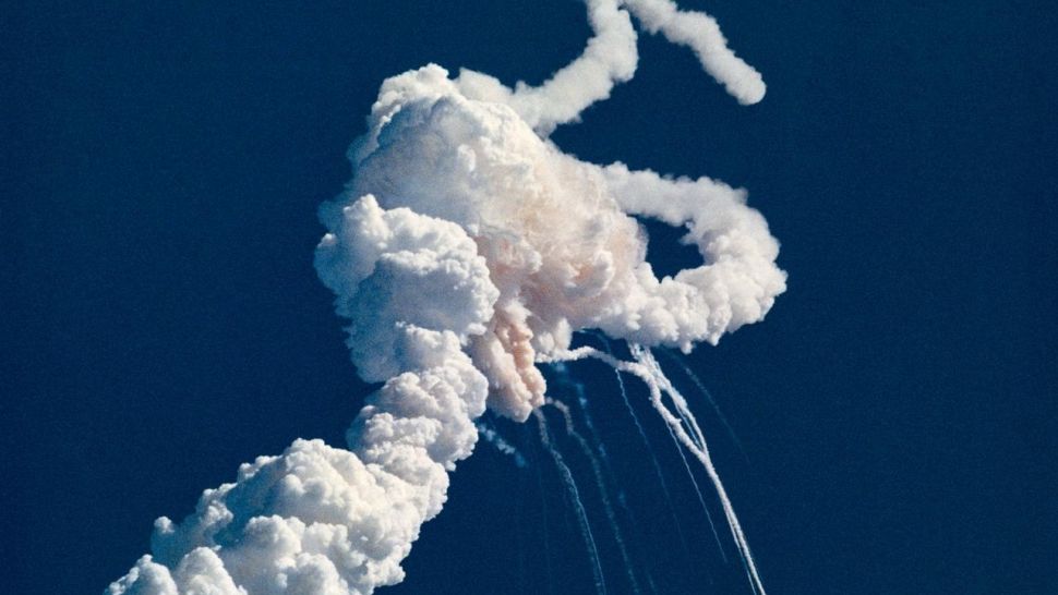

The fatal Challenger explosion of Jan. 28, 1986 was in the mind of the Columbia Accident Investigation Board, which noted similar organizational difficulties at NASA that contributed to the two tragedies. (Image credit: Nasa)
