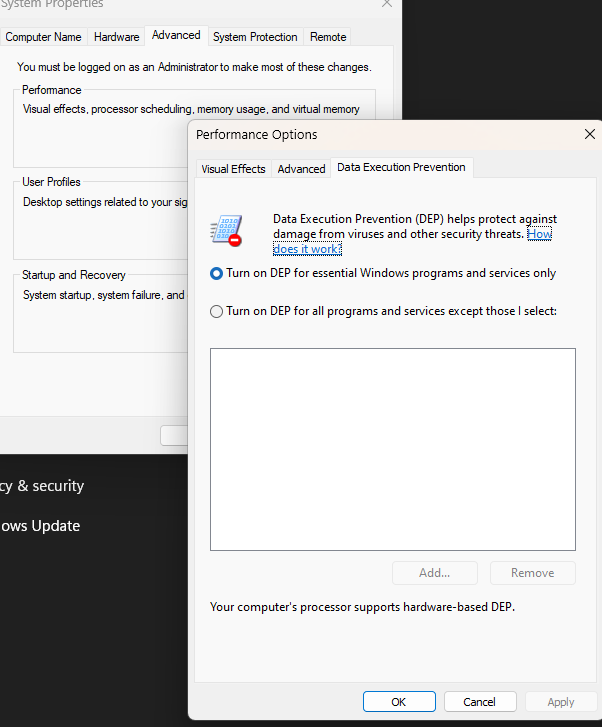

Pinged you on Discord. Your config is bad and all those cvars are not required.
My suggest:
1. Create new profile in ET. Don't load any config. Try to connect and see what happenes.
2. If it works -then fix u config/
Also share u below configuration for PC. Need info on your windows OS, Windows language, etc.
Thanks for your reply. Setting DEP for essential windows programs and services only did the trick.
For some reason mine was on for all programs.
The only thing i do not understand that it was not kicking me out of your Jay1 server, only ETPRO ones...
