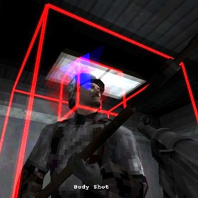

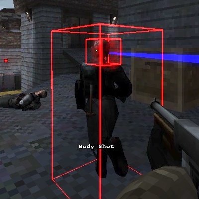

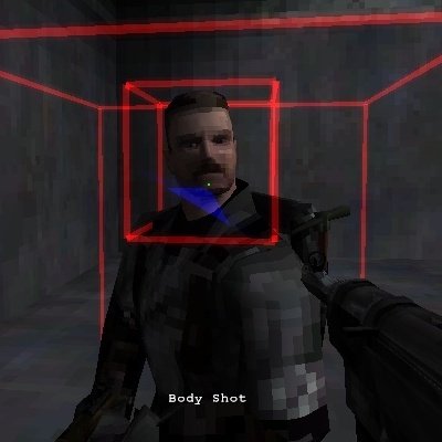

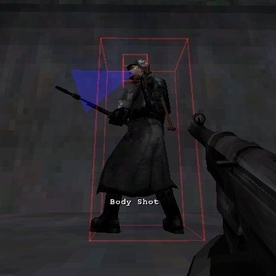

In the screenshots below you can see that body shots are scored when a reasonable player would expect a headshot in some of the scenarios described above. The boxes and bullet traces are generated by using g_debugBullets 3 on a test server.

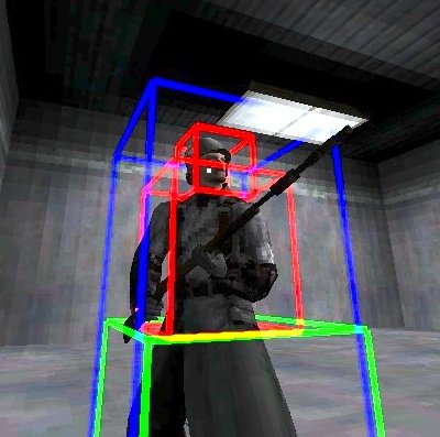

Below you can see the hitboxes as rendered by version 0.9.0 with g_debugHitboxes 1 on a test server. It appears as though any shot that passes through the red torso box is always scored as a body hit even if it would otherwise hit the head.
