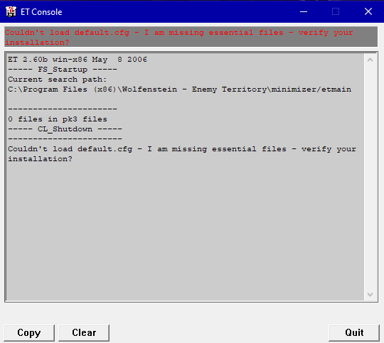

I came back to ET today, and I still had the game installed with a lot of mods or something like that installed. I wanted to remove all of them to play it vanilla (or legacy or whatever it's called). I didn't know how, so I just completely uninstalled the game, I kept the etkey as everyone says that everywhere I go. I downloaded the installer from the game's page, and after installing it, it gave this error message. image.png.83750a2a6b1645045aba9dcf21349f27.png

Your "current search path" is corrupted.
It should not be "... Territory\etminizer/etmain "  It should not have that minimizer section in it.
Your "current search path" should be "C:\Program files (x86)\Wolfenstein - Enemy Territory/etmain".
I have a shortcut to ET.exe in a folder on my desktop (Win 10).  The properties for the shortcut include these:
Target "D:\Program Files (x86)\Wolfenstein - Enemy Territory\ET.exe"  I installed my ET in D-drive, not C-drive.
Start In "D:\Program Files (x86)\Wolfenstein - Enemy Territory"
In the Advanced tab page, I have checked "Run as Administrator".
I would check those two properties, Target & Start, for the proper paths first.

Thanks so much for the help, I dunno why the shortcut was set to that path, the installer just did it for some reason.
