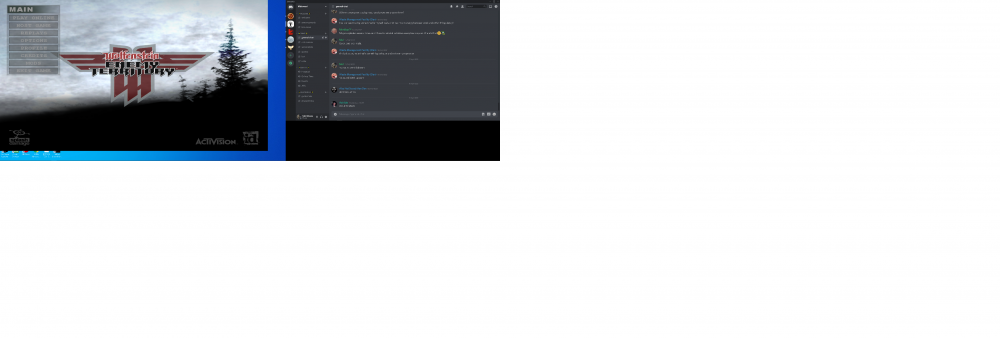

Internomad Posted April 20, 2021 Author Share Posted April 20, 2021 So, you can see it is not fully Full Screen. Quote Link to comment Share on other sites More sharing options...
MikeSlayer Posted April 20, 2021 Share Posted April 20, 2021 ok thats def not 1080 try typing in game /r_fullscreen 1 /vid_restart Quote Link to comment Share on other sites More sharing options...

Internomad Posted April 21, 2021 Author Share Posted April 21, 2021 17 hours ago, Feint said: try r_mode -1 then vid_restart autoexec.cfg Tried that too, still the same. I'm going to put my config up here, see if any of you can spot any obvious errors. Quote Link to comment Share on other sites More sharing options...
MikeSlayer Posted April 21, 2021 Share Posted April 21, 2021 change the customwidth to 1920 and the custom height to 1080 you have it set to 800 x 600 thats why it looks small in the corner Quote Link to comment Share on other sites More sharing options...
