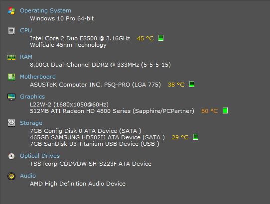

I cancelled the order and looked for a newer gpu, found one with the almost the same price, but it has a passive cooler. Anyone have experience of these how good it is for cooling? Gpu is geforce gt 710. I have only one 12 cm fan and I added a small fan few years ago when I had attached 2 gpu's inside on crossfire state. All fans speed can be adjusted by mb own program.

MB SPECS
PC specs:
