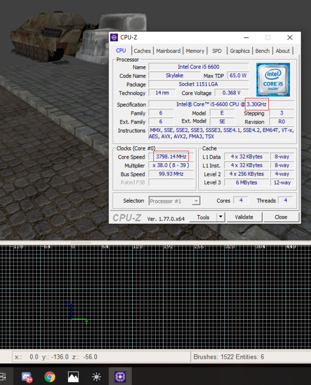

2.0 Ghz shows because it is not under load. You see I have something in the background turned on. The stupid shows 0.36V heh ðŸ˜œ

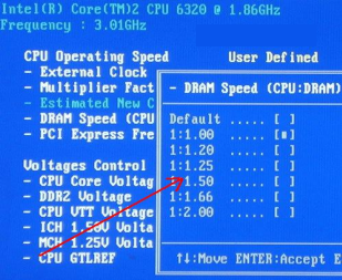

In bios, you need to set the RAM divider corresponding to 1333Mhz.
For example:
FSB - 333MHz, memory multiplier 1: 1.25,
that is: 333 x 1.25 = 416.25MHz, which gives the real clock speed of 833MHz (to get it, multiply the clock speed by 2, because it results from the DDR architecture)

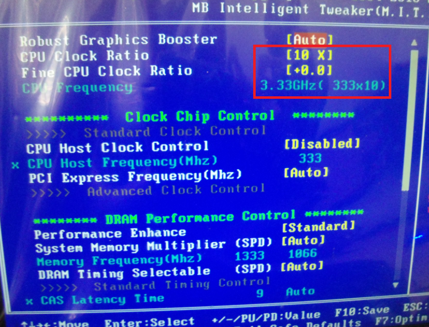

You can even give yourself a bigger CPU Clock Ratio to get a higher CPU frequency.
Example with e8600 processor:

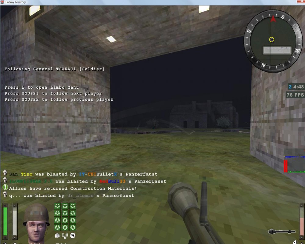

you could also try turning the graphics right down it will help hold fps you seem to play with some high detail settings
i would try
/r_primitives 2
/r_picmip 3
/r_texturebits 16
/r_detailtextures 0
there is many other settings too post your config and we can have a look maybe get ET to run a bit better till u upgrade

Thank ya mate but already have everything on lowest, u could easily mistake my ET for minecraft haha
