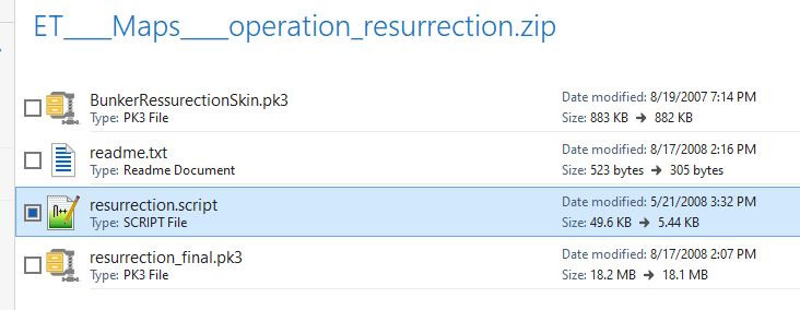

Leader RedBaird Posted December 5, 2020 Leader Share Posted December 5, 2020 (edited) 20 hours ago, Rohambili said: Hey Hello! Where to need to place the resurrection.script file? readme say place into the mapscripts folder... Where? ET Root folder? etmain? shrubet? And what is the name of that folder? maps? or mapscripts like readme sayd? I run shrubet server. I don't see any mention of a "resurrection.script" in the readme.txt file that is inside this "resurrection_final.pk3" that I just downloaded, nor in the one in my etmain folder. (nor in any other version that I have in etmain). There are no "resurrection.script" files in any of them. ======= I DID FIND a "resurrction.script" file in WolfFiles.DE's backups on GitHub from Feb 2018. (Which I just discovered now! 😮 ) ======= It is found in the ET sub-folder as " operation_resurrection.zip Download " A "resurrection.script" is found in that pk3. The Readme.txt is show below. Operation Resurrection (Final/Fixed) ------------------------------------ Made by peyote http://peyote.et.googlepages.com A fixed version of the map, the original contains buggy shader script, which can corrupt other maps and itself. A Skinpack changing Axis to Zombies, only in this map. Installation: ------------- Place the *.script into mapscripts folder on the server; and the *.pk3 into the mod folder. Works with, NoQuarter, Jaymod, Etpub, Etpro, and any other mod which supports etpro mapscripts. Here are the files inside the pk3: NOW, someone who can help with an ET Server Setup can step in to help him. 😄 Edited December 5, 2020 by RedBaird Quote Link to comment Share on other sites More sharing options...

BlackWolf Posted December 9, 2020 Share Posted December 9, 2020 The .Pk3 goes in etmain. The .Script file goes inside a folder called mapscripts, inside the mod folder. I.e. /shrubet/mapscripts/resurrection.script P.s. Shrubet is outdated and subject to vulnerabilities. You should consider a more up to date mod. 1 2 Quote Link to comment Share on other sites More sharing options...
