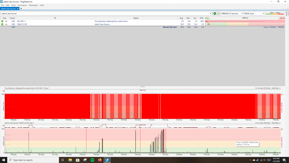

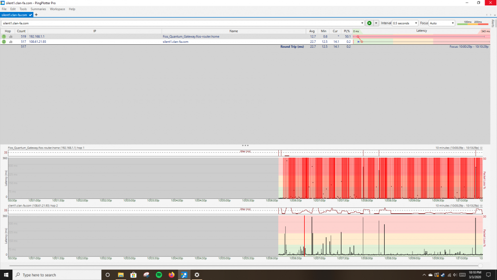

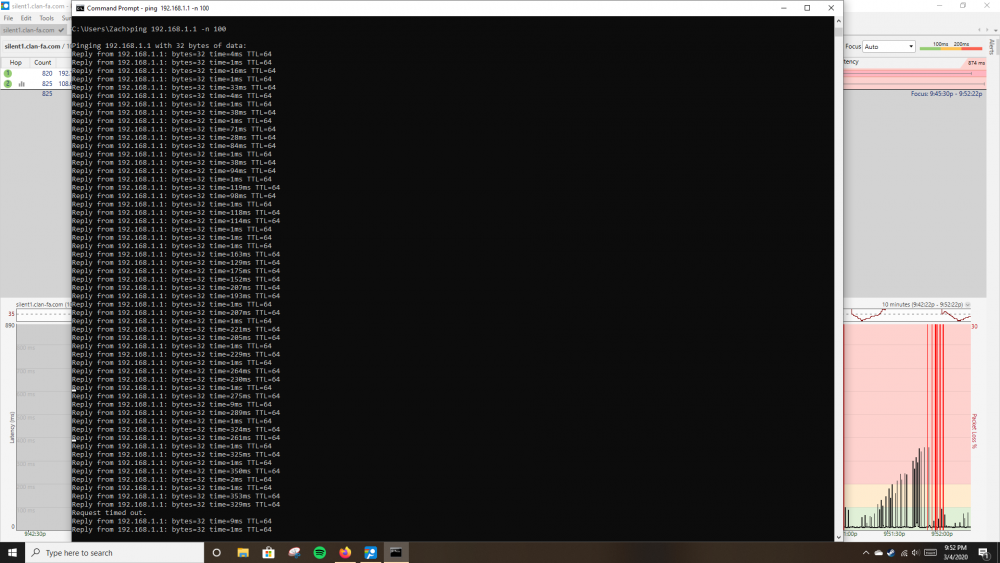

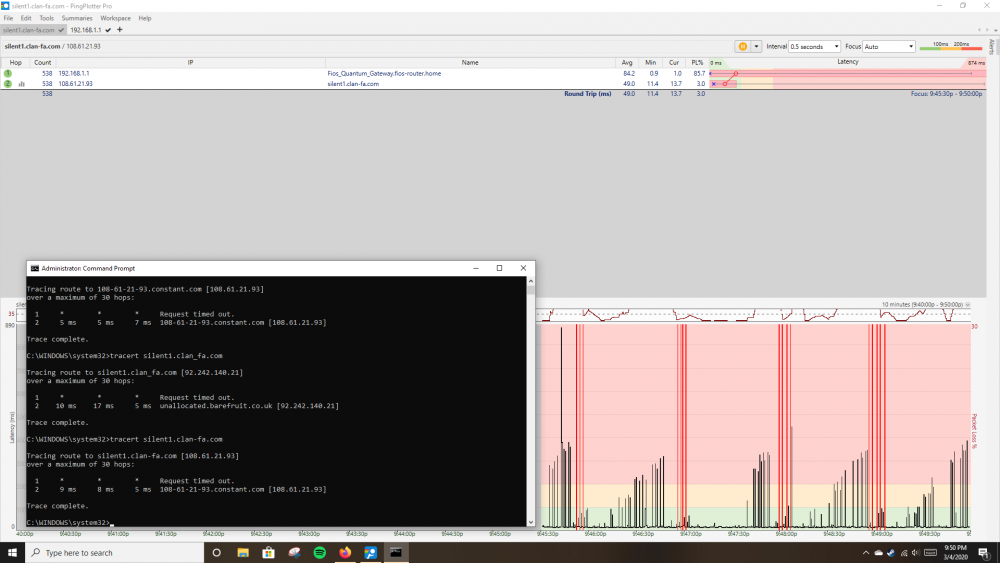

In the last week or so I started getting crazy lag on Silent 1.  The only change I made was updating Windows 10 to v1909 (Windows updates usually screw me over).  I've ran some diagnostics and I just don't understand the results.  Using PingPlotter, if I set the target to Silent 1, I get 90% packet loss between my PC and the router.  If I set the target to my router, I get <5% packet loss.  There are no hops in between my router and the server according to tracert and pingplotter, and i usually have <10 ping on Silent 1 as a result.  Attached are a handful of screenshots of results for those of you who may see something I'm missing.  Any ideas?!
