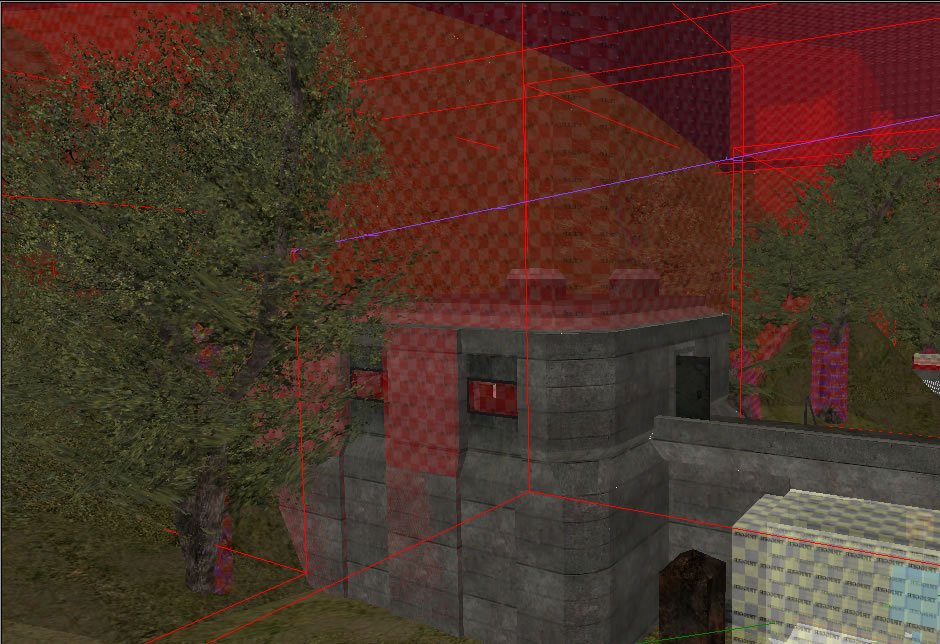

No the invisible clip wasn't there but was added yesterday I do however have to rotate the tree it is inside the building
there is some clipping that needs to be fixed for new models almost finished that

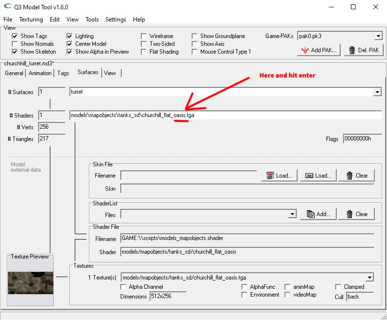

I cheated on the turrent so who ever needs to know churchhill_turrent_oasis.md3 in pak0.pk3 is missing a tag_ file and is corrupt my opinion even after blender remapping the shader on it the tag_ location would change origin but the gun would still shoot from the belly of the turrent so just do this below for a quick change
just change the shader path to oasis for models/mapobjects/tanks_sd/churchhill_turret.md3
and make sure you open this from GAME to make the Shader File read it must be in pak0.pk3 to be commited or changed
change from churchill_flat.tga to churchill_flat_oasis.tga
the shader file modelsmapojects must also contain the correct shader path you can modify GAME pak0.pk3
but just remember you changed it and change it back from a backup file so you don't get missmatch client errors when connecting to servers

But it still needs some fine tuning for skips and hints and brush works unseen to stable the map with using animated trees
The skybox is fixing to get trashed from what was left the func_group with the old shader face counts thinking of clipping the map in half and divide the shader counts it has some fps issues but shouldn't result in any max entity counts can support up to 100 bots now hehe if your pc can handle it
but really it's got to many clips and hints right now from default map all shader faces count they are rendered even the unseen ones the processor has to handle them
I may even remove them all and just stick to what I was doing before less is better skips don't really work in world on in rooms big area's at 4000 blocks wouldn't have no effect unless it's behind a clip in front of a entity
