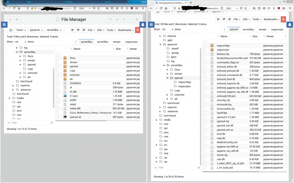

Blackwolf! I already have 3 servers runing with ET3.0
Yeah! The nq 1.2.9 readme says only et 2.6b supported. And if i try to use the retail version of 1.29.b6 like you wrote Blackwolf, with et3.0 does not even let connect with 2.55. But look at this server: 5.9.148.175:27030
That let me in with 2.55 client and does not spam anything (how the f?)

I've just taken a look at the official documentation for ET 3.00 and it does indeed state that ET 3.00 won't work with NQ 1.2.9. NQ seems to have a check in it that ensures it's only running on 2.60b. The server you mention appears to have the version removed to bypass the check, although I don't have that executable to hand to share unfortunately.
As mentioned before though, 2.55 is pretty much dead. There is no official download for 2.55 now and the masterlist there is rather lacking in servers. Most F|A servers now run ETL now so don't allow 2.55 players to connect, and they're well populated. I very much doubt you'll be missing out on many players :)
