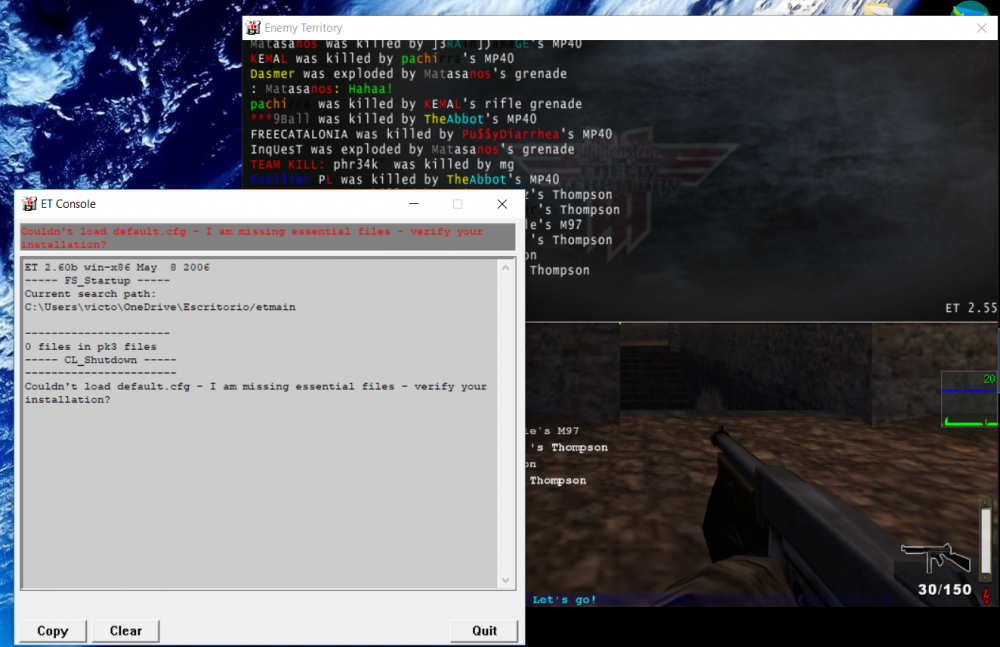

Hallo guys, today, i joined to FA jaymod1 and i was lagging a lot, i did the command for decrease the lag, but, then another screen appears, never seen that one, and then, i lost connection. do someone knows whats happened??
C:\Users\victo\One Drive\Escritorio/etmain may not be a good location for ET.
Can You copy to: C:\Program Files\ Wolfenstein - Enemy Territory?
Make new shortcut of ET.exe and right-click, Properties, Compatibility: Run as Admin.
I do agree that your path is very curious but more often than not this problem is caused by an error in pak0, best solution is to save your etkey and silent.dat and reinstall
