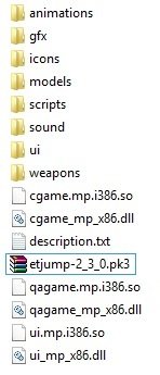

and copy the three files out of the .zip you just downloaded into the folder etjump
Open up you new etjump folder, it should have only these 3 files in it now:
etjump-2_3_0.pk3
qagame.mp.i386.so
qagame_mp_x86.dll
and copy the contents of that file into your etjump folder as well. It should now look like this:
That's it!
