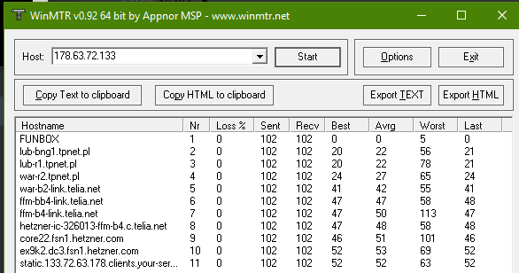

Here are screenshots, winmtr for nq1(178.63.72.133), b2 and tracert for nq1 and b2.
Nq2 and Nq3 are the same as nq1.
Screenshot_517.png.c92986aaff5ee249e88342c4244c686c.pngScreenshot_515.png.22dfb73c8f11afc60d0af0a7d4c30143.png
Screenshot_518.png.4a502266ea0e4efb95ead0c67e10661a.pngScreenshot_516.png.afd719124cc687a1928d30daaf8dd833.png

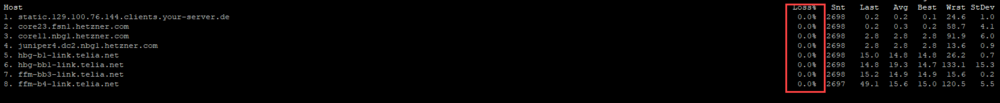

Upstream issue. Opening ticket with data-center tech. They will blame on Telia. It seems US route is different and for me it's 0% packet loss. Time to fight it out.

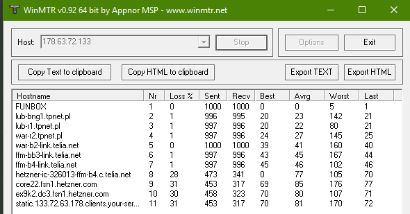

As requested 1k packets. //just for the books
From server to u - Not sure what's the issue is but it seems your upstream is having packet loss and no packet loss on downstream?
  • Solution
Found the issue. My network cannot handle more than 1480 mtu, and as always windows 10 resets it itself to 1500.... Eventhough netsh was set to store=persistent.
Had to modify some stuff in registry...
Anyways solved, case closed. Thank!
