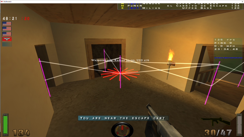

There's 2 white lines to waypoint in front of objective?
I can't see...
If not, You need 2-way.
yes there is a two-way waypoint connecting the exit but they still run in front of it, if that makes more sense, he ran in there for a moment- i gave him an "addflag defend" to see if he stops there but typically they run in front of it. no matter how i change the points they don't stop in front of the exit.

Investigate route priorities...
Some go one way, Some another.
PathThrough would fix that.
You could try cappoint flag on waypoint.
/bot waypoint_addflag cappoint
Try adding cappoint to waypoint
*Nearest waypoint
I used the command. unfortunately it still runs in front of it. once it gets to the point then it doesn't end the map unless i have entered the obj.
i used cappoint, defend, jump (the last one in case it doesn't detect where to stand)
