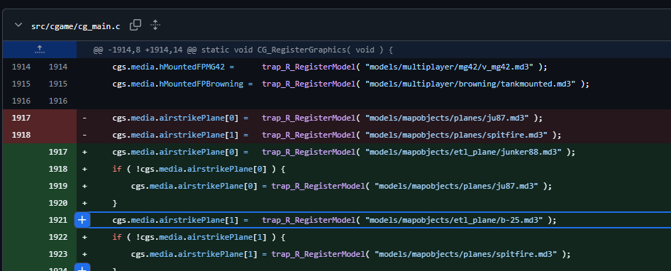

  • ET Member
0 means failure no need to double register one model as another thats going to cause a lot of issues I assume it was to copy ETLs plane instead of the one shipped with NQ? But your going to have weird crap overwriting one model as another if the map contains a file with that name better error handling is needed with the plane swap if its always why bother the fall back to old model?
You also removed the wide screen part of ETL but call it still? You need to fix your menus for 16:9 why you hate wide screen Suspicious Kenan Thompson GIF
Why did you completely remove the bounds checks of CG_GetGameModel and the missile cam? Are you removing these entirely soon? and removed the CG_RestoreProfile guard? This seems like asking for crashes?
Also -1 for s.time do NQ scripts not expect this to be 0 the default? I support the call but may cause issues best to adapt the existing behavior to your ETL implementation so community knows what to expect but im not sure this breaks anything currently just a small note
Why rewrite of UI_DrawProportionalString / UI_DrawBannerString to TTF in cg_drawtools.c that nothing in cgame calls??
You also removed GAMESOUND_MAX >= MAX_SOUNDS guards completely allowing a simple crash to be done via console from ANY game client killing the server instantly??? wtf?
Even more remote crashes? you undid the fix?
 src/ui/ui_gameinfo.c you edited
The code puts a file name into a 128-byte buffer using strcat(), but file names inside PK3 files can be much longer than that.
A client could send a PK3 with a very long .arena file name. When the client loads it, the name can overflow the buffer and corrupt the stack boom dead server.
ET/ETL/NQ had already fixed this by using Q_strcat() with the buffer size why undo it?
The code was edited, but the unsafe strcat() was left in place. Then the "AGENT.md "rule was even added saying not to use strcpy() or strcat(), while these old uses were still there confusion...???

  • ET Member
Fireteam 13 unguarded could push buffer manually with requests to crash server if in bad memory region and the max lighting crash still exists but most seems fixed
Edited by RNGesus
I will take care of that now I'm about to push some more fixes to Git so I will take a look at those before I do that and update the change log with the rest of the items that were changed. I really appreciate all the help, another set of far more experienced eyes than mine really helps.

  • ET Member
The main bug that jumped out at me in my short chance to review is the extra Cui_Widexoffset being added after the position is already scaled to pixels.
I’d remove that offset from both transforms and remove the fullscreen guards around it. The normal scaling already puts everything in the correct place, and this extra offset is what causes the UI to shift right, menus to go off-screen, and the loading screen to jump strangely.
A few other things I’d fix:
Remove the hardcoded 608 menu centering check.
Fix menu dragging so it updates the same position the draw code reads.
Restore the Linux build script to use a relative path instead of a developer-specific path. """ROOT_DIR = sys.argv[1] if len(sys.argv) > 1 else r"C:\Users\Dylan\Documents\...""" I dont know if you even intended to leak your name but be careful AI will leak stuff like API keys!
The IPv6 buffer changes don’t fix the real truncation issue. Fix the smaller upstream fields instead.
Don’t catch bot access violations and keep running. That can hide memory corruption never do this really its really bad code practice
Don’t return config string index 0 on overflow because 0 is valid.
Make the login lockout configurable and fix its timer across map changes.
Make sure the packaged plane models match the models the code actually loads.
Update the AI instruction files so they stop recommending the old archive layout or just remove them entirely
Edited by RNGesus
