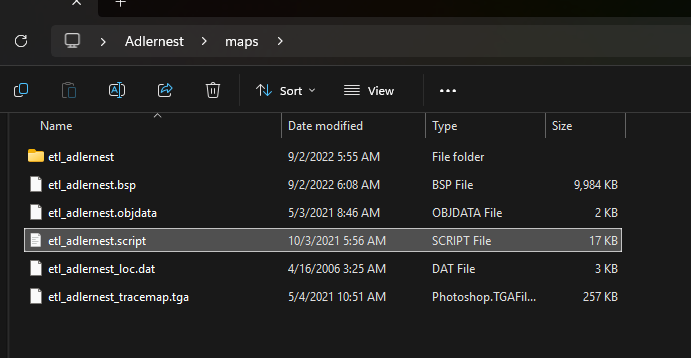

Should be located inside the map.pk3 file.
Same as you would change the Allies. Just open the .pk3 file and usually there will be a folder labeled maps and inside there you'll see something like <mapname>.script like shown below
Open that with VS Code or even notepad if thats your poison. Right near the top of the file you'll see
	spawn
		wm_axis_respawntime 30
		wm_allied_respawntime 20
Just fix these values, save, repack as .pk3 and should be good to go from there.
Not sure if there is any easier ways but this has always been one for me 😄

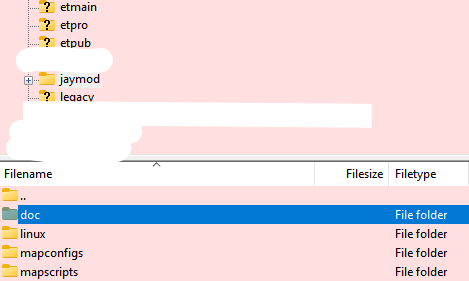

Here from test server some ss of folders (filezilla view)
Inside mapconfigs
Inside default.cfg (open with notepad)
Edited by RendeL
wrong image
