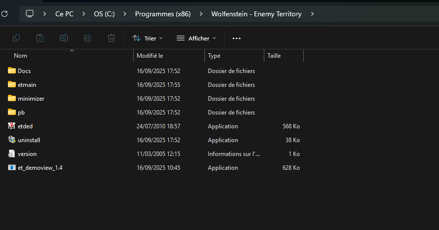

Jadream Posted September 16, 2025 Posted September 16, 2025 What do you guys generally use ? I have VLC media but it doesn't read the videos I download. Quote

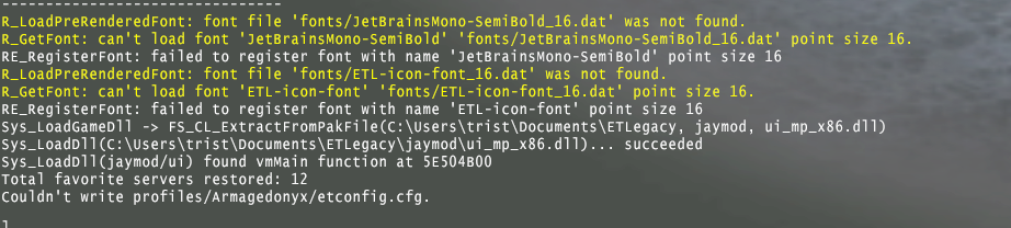

0 Jadream Posted September 16, 2025 Author Posted September 16, 2025 2 hours ago, Snake in the Grass said: 1. Open the game 2. Bring out the console 3. type /demo [name of the demo] No need to install anything. At least, that's how i do it. Further points to consider: - If it doesn't find out the demo, you need to load the appropriate mod so the file path will be the right one - Before that, you might want to rename the demo file to something easy, like the name of the player you are focusing on. - The file extension is dm_83 by default, if it's not the case, like its dm_84 or else, you need to type the full file name. Ex: /demo snakey => /demo snakey.dm_84 I tested, nothing happened. The z4nkro cheater report demo is dm_83 format, so I shouldn't have to write the whole name of it. I also loaded Jaymod which was the mod the potential cheater was on. Instead, these messages appeared on the console : Quote

0 Platinum VIP Snake in the Grass Posted September 16, 2025 Platinum VIP Posted September 16, 2025 1 hour ago, Armagedonyx said: I tested, nothing happened. The z4nkro cheater report demo is dm_83 format, so I shouldn't have to write the whole name of it. I also loaded Jaymod which was the mod the potential cheater was on. Instead, these messages appeared on the console : If your file is already in the right format, no need to add any file extension. I am feeling the demo is either not at the right place, or it is not the right file name: can you locate the demo file in the right directory of the right install ? the path should resemble something like "ETLegacy\jaymod\demos". The demo automatically sets a name for the file which is based on date, time and map. So if you haven't renamed the file yet, it should look like "2024-08-06-181735-warbell" (hence the name for renaming 😉). If the demo file is not present in there, please look for it before anything else, typically by making a search of the file on the entire ET install, and if not, on the entire disk; then once find, move it to the above directory. Just for future reference, please note that it is the mod that the player who recorded was on, not the mod of the potential cheater, though obviously, if you're on same server, you should be under same mod. Quote

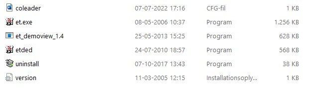

0 Leatherface Posted September 16, 2025 Posted September 16, 2025 This my 2.60b version with demowiever 1 Quote
0 Jadream Posted September 16, 2025 Author Posted September 16, 2025 22 minutes ago, Leatherface said: This my 2.60b version with demowiever Am I good now ? Quote
0 Leatherface Posted September 16, 2025 Posted September 16, 2025 19 minutes ago, Armagedonyx said: Am I good now ? Looks ok Quote
