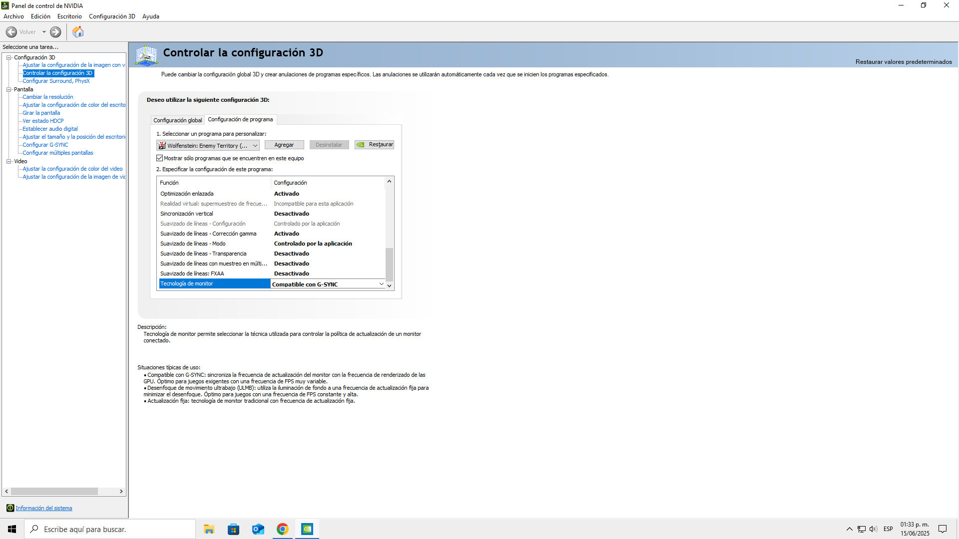

Betinho Posted June 15 Posted June 15 If you have a display with GSYNC technology, you need a DP cable for it to work. If it doesn't have GSYNC, I honestly understand that it's almost the same whether you use one cable or the other (some say DP is better, you can try it if you want). The difference is whether you can use GSYNC (you need the monitor and the GPU; the GPU has it; it remains to be seen if your display has it too). https://www.nvidia.com/content/Control-Panel-Help/vLatest/en-us/mergedProjects/nvdsp/Variable_Refresh_Rate.htm#:~:text=G-SYNC eliminates tearing%2C and,or G-SYNC Compatible display. If your screen has GSYNC, after purchasing the cable, make sure in the Nvidia CFG control panel that GSYNC is activated, there you will be able to see the difference in the game. Quote

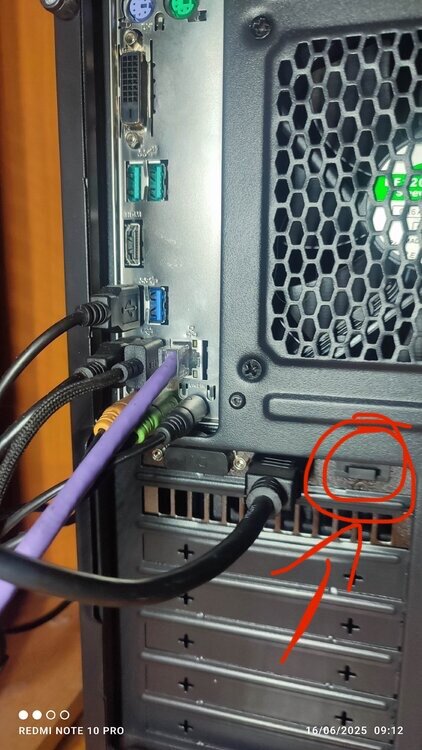

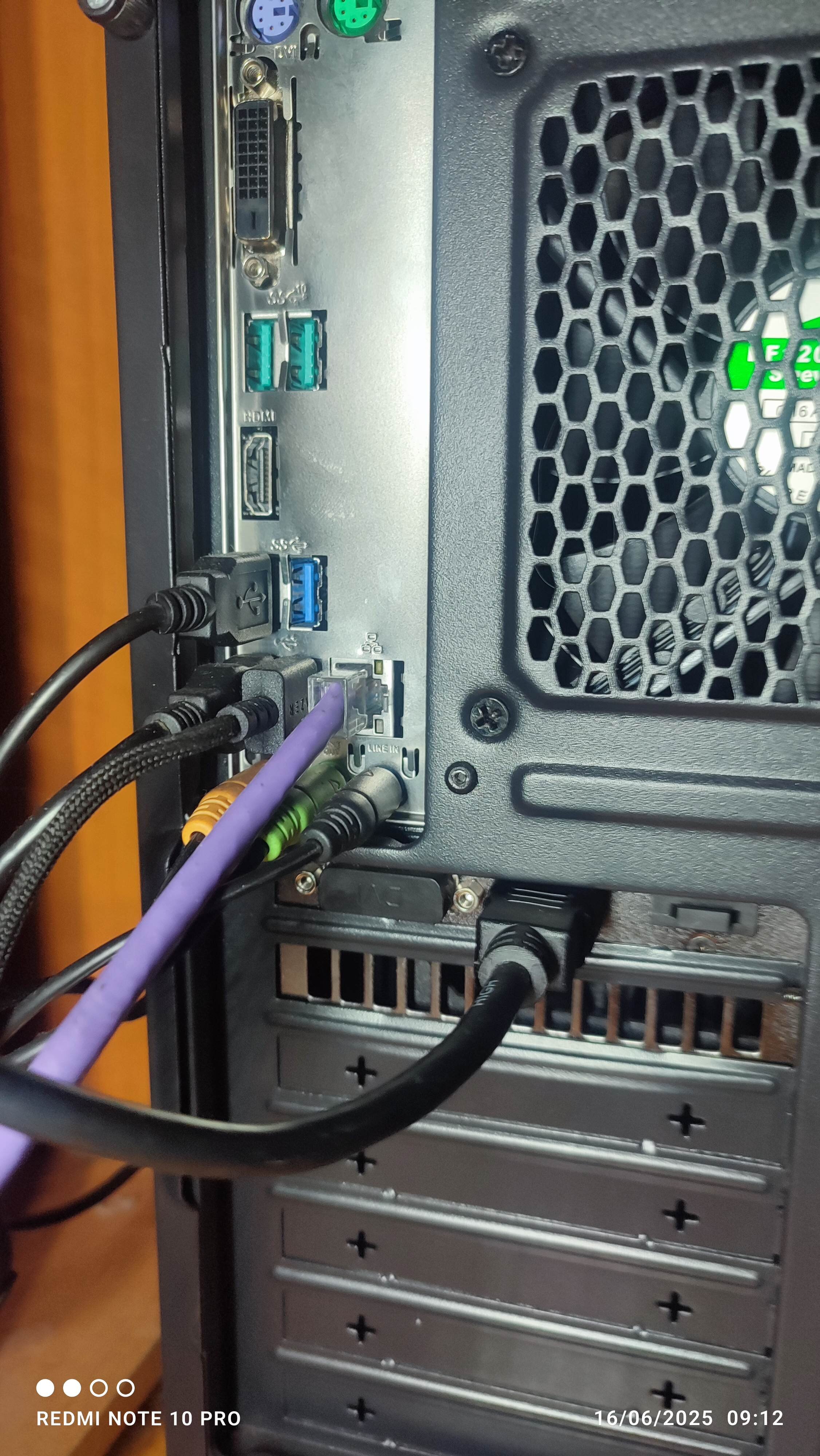

OliveiraptV Posted June 16 Author Posted June 16 so my pc doesnt have any dp port only have hdmi so i have to use it hdmi or is there any converter to dp using hdmi port Quote
Aardappel Posted June 16 Posted June 16 On 6/16/2025 at 8:41 AM, OliveiraptV said: so my pc doesnt have any dp port only have hdmi so i have to use it hdmi or is there any converter to dp using hdmi port Expand there it is, you need to pull that cover plug out Quote
TBAR Flash Posted June 16 Posted June 16 (edited) hmmm, maybe a lilbit too tiny for a displayport connector... Oli please can u unplug this big fat black cable in the middle and then make a picture for us. Edited June 16 by TBAR Flash Quote
Solution Aardappel Posted June 16 Solution Posted June 16 On 6/16/2025 at 8:50 AM, TBAR Flash said: hmmm, maybe a lilbit too tiny for a displayport connector... Oli please can u unplug this big fat black cable in the middle and then make a picture for us. Expand I had the same card, its Displayport 1.4 😉 1 Quote
