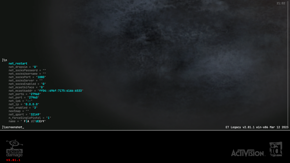

Hi TomekKromek
thats TAB search ET legacy, how come this "n" cvar appear in my console then ? if there is no such cvar in ET  :)
You joined once one of the Nitmod servers and you got this cvar in your config and now you have it everywhere. You can do clean install and you won't see it there.
Look below. I have nice cvar there - devs 20 years ago forseen that!
Edited by TomekKromek
