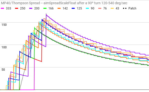

On 5/10/2022 at 10:04 AM, the cake is a lie said:
- remove FPS dependent recoil
- remove FPS dependency from turn spread
did i understand correctly that these fixes will fix the crosshair twitching at different fps below 125? for example, i play with 62/76/85 fps on some maps for technical reasons, and the spread from bullets increases than with a stable 125 fps, visually and physically.
if i didnt understand it correctly, then please explain it to me. thanks.
Generally yes. Everyone will get the same recoil (pistols, MG42, sniper) and the effect of mouse movement on bullet spread will be standardized.
There will still be a tiny bit of variation because of how floating point math works but it shouldn't be noticeable.
This is how spread currently grows when making a steady 90 degree turn at various frame rates and how the patch (dotted line) standardizes spread to be most similar to com_maxFPS 166:
860220352_MP40_ThompsonSpread--aimSpreadScaleFloataftera90turn120-540deg_sec.png.c69f68385b178c3f64610fd5e885e3e3.png
The slight twitching of the crosshairs and how it varies with FPS can't be entirely standardized because of how it interacts with the display refresh rate but it will hopefully be better than it is now.
