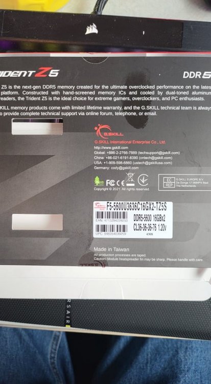

EVIL BUTTERS Posted December 12, 2021 Share Posted December 12, 2021 (edited) Ok here we go. Just put together my new rig. Old Rig was 5950x 128 meg ram RTX 3090. Now I got the new i9 12900K 64 megs DDR5 Trident Z5 DDR5-5600 CL36<-------Crazy exspensive... Poo POO. BTW my 5950x blows away this system already poo poo. So my question is. When I go to my bios <yes it's updated to the newest version. 0803> the auto with no XMP is low numbers not even close to 5600. I enabled XMP and it shows 5600 I save and it wont restart. SO I went and maunally set the frequency 20 times found only 4600 the highest it will only work. Why pay for faster numbers if it won't work??? I have put pictures up of my screen. IS it me or the sticks or Bios are not ready to go that fast yet? Please help me. Peace Butters SUCK IT!!! Edited December 12, 2021 by EVIL BUTTERS Quote Link to comment Share on other sites More sharing options...
Long Posted December 12, 2021 Share Posted December 12, 2021 (edited) Maybe it helps if you upped the voltage to 1.435v? To reach those speeds, we upped the voltage to 1.435v on both VDD/VDDQ and started to train the RAM from 5200Mhz to 5600Mhz at very loose timings. The PC refused to boot at 5600Mhz but reducing it to 5400Mhz worked nicely. We then started to tighten the table clocks, and after many different combinations, crashes and restarts, ended up with 36-39-29-74-2T. For some reason, this MSI motherboard wouldn’t change the Tras Pre time- whatever we selected would just result in 39. Here are the results from AIDA64. https://www.techradar.com/news/we-overclocked-the-intel-core-i9-12900k-heres-how-far-we-got Edited December 12, 2021 by Long Quote Link to comment Share on other sites More sharing options...
EVIL BUTTERS Posted December 17, 2021 Author Share Posted December 17, 2021 Thank you long. I did what it said raised the voltage. got it to 5200. Now I want to OC the Processor LOL but it looks a little more complicated LOL. Thanks Again!! 1 Quote Link to comment Share on other sites More sharing options...
