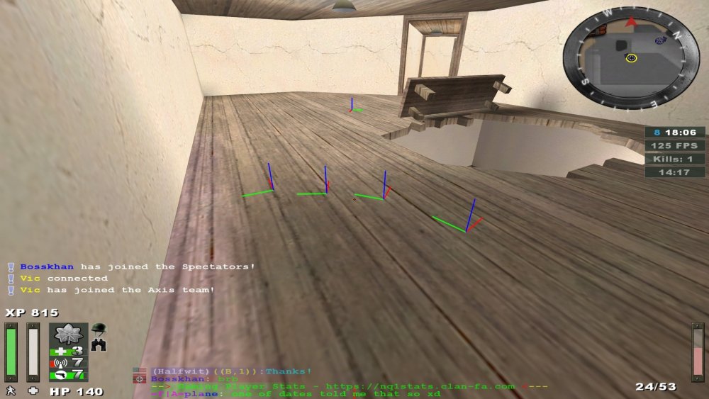

Instead of making another topic on an issue I have with NQ, I thought I would post it in an original topic I made sometime ago.
If I open up ET, and connect to NQ, I have no issue, the issue starts when a new map begins, for some odd reason, my sound goes weird and high pitched, I also lose my gun, and I play on /cg_drawgun 1, and also the medic packs and ammo packs are a different pixeled image, I also get a red and or blue line at the bottom of my screen in the center. I will upload a image that I screenshotted on NQ just a moment ago, this happens every time there's a new map on NQ, any idea's and or solutions would be helpful, and I would be thankful if anyone and or anybody can resolve this.
