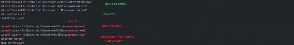

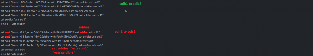

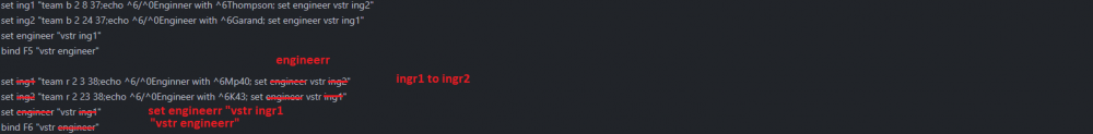

BTW everything works BUT swapping teams from axis to allies....
You made a mistake, both scripts have this name.
You have entered the first script for your allies. And then for the axis. Scrypt for the Axis replaced the allies. As a result, you only have the script for the axis. And that's why it doesn't turn you into allies. ?
I think you can see your mistake. ?

Corrected:
set soldierallies1 "team b 0 5 8;echo ^6/^0Soldier with PANZERFAUST; set soldierallies vstr soldierallies2"
set soldierallies2 "team b 0 6 8;echo ^6/^0Soldier with FLAMETHROWER; set soldierallies vstr soldierallies3"
set soldierallies3 "team b 0 35 8;echo ^6/^0Soldier with MORTAR; set soldierallies vstr soldierallies4"
set soldierallies4 "team b 0 31 8;echo ^6/^0Soldier with MOBILE (MG42); set soldierallies vstr soldierallies1"
set soldierallies "vstr soldierallies1"
bind F1 "vstr soldierallies""
set soldieraxis1 "team r 0 5 3;echo ^6/^0Soldier with PANZERFAUST; set soldieraxis vstr soldieraxis2"
set soldieraxis2 "team r 0 6 3;echo ^6/^0Soldier with FLAMETHROWER; set soldieraxis vstr soldieraxis3"
set soldieraxis3 "team r 0 35 3;echo ^6/^0Soldier with MORTAR; set soldieraxis vstr soldieraxis4"
set soldieraxis4 "team r 0 31 3;echo ^6/^0Soldier with MOBILE (MG42); set soldieraxis vstr soldieraxis1"
set soldieraxis "vstr soldieraxis1"
bind F2 "vstr soldieraxis"

set engineerallies1 "team b 2 8 37;echo ^6/^0Enginner with ^6Thompson; set engineerallies vstr engineerallies2"
set engineerallies2 "team b 2 24 37;echo ^6/^0Engineer with ^6Garand; set engineerallies vstr engineerallies1"
set engineerallies "vstr engineerallies1"
bind F5 "vstr engineerallies"
set engineeraxis1 "team r 2 3 38;echo ^6/^0Enginner with ^6Mp40; set engineeraxis vstr engineeraxis2"
set engineeraxis2 "team r 2 23 38;echo ^6/^0Engineer with ^6K43; set engineeraxis vstr engineeraxis1"
set engineeraxis "vstr engineeraxis1"
bind F6 "vstr engineeraxis"

set covertallies1 "team b 4 25 37;echo ^6/^0Covert with GARAND; set covertallies vstr covertallies2"
set covertallies2 "team b 4 33 37;echo ^6/^0Covert with FG42; set covertallies vstr covertallies3"
set covertallies3 "team b 4 10 37;echo ^6/^0Covert with STEN; set covertallies vstr covertallies1"
set covertallies "vstr covertallies1"
bind F9 "vstr covertallies"
set covertaxis1 "team r 4 32 38;echo ^6/^0Covert with K43; set covertaxis vstr covertaxis2"
set covertaxis2 "team r 4 33 38;echo ^6/^0Covert with FG42; set covertaxis vstr covertaxis3"
set covertaxis3 "team r 4 10 38;echo ^6/^0Covert with STEN; set covertaxis vstr covertaxis1"
set covertaxis "vstr covertaxis1"
bind F10 "vstr covertaxis"
