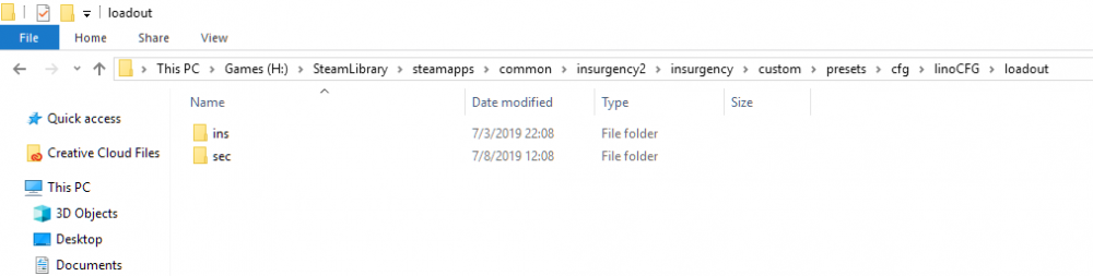

After pasting it, in the same location create a folder: presets
Inside the presets folder, you will need to create a bunch of folders like:
//…./presets/cfg/linoCFG/loadout/
After you are inside loadout folder, create two folders named: ins and sec
Now the loadout folder should look like:
Step 5: (Since we are playing coop, don’t worry about ins folder).
Go inside sec folder and paste the config files in there.

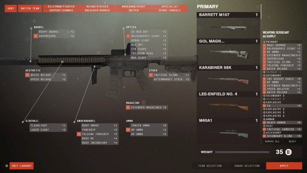

After doing 1 and 2, …..It should look like:
Console:
Loadout screen (rifleman1.cfg) :
If you click on rifleman again, you will load rifleman2.cfg (which is for normal servers) so you wont see any guns probably. Click on it again, then you get a mg loadout.

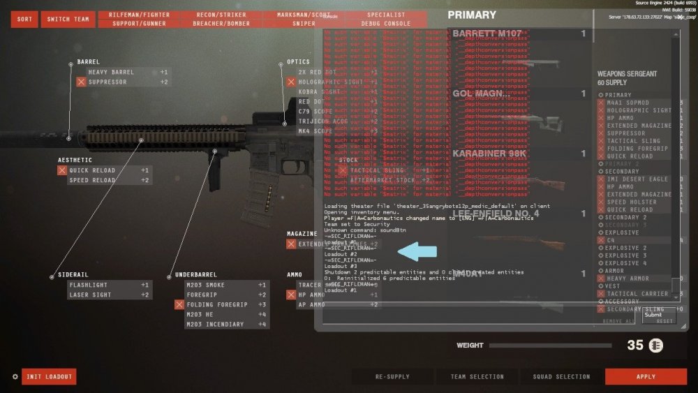

You can check which cfg is loaded by going to console and it will show you the current config (although maybe hard to find it).
Successful load of the preset will look like:

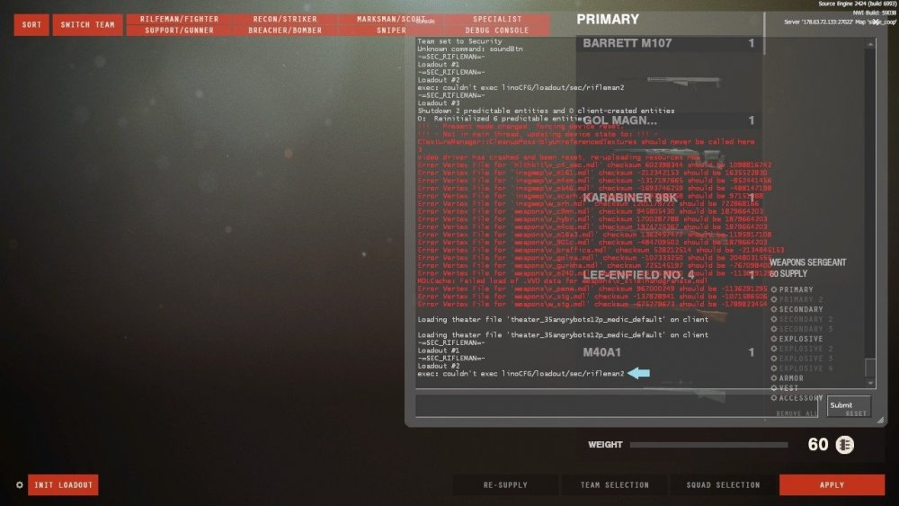

2. I click on Rifleman button and the whole loadout is just cleared.
  • A. Open console, if the error says “cannot exec rifleman1.cfg” or something of that sort, then you made an error in step4. Check the directories, and check if the configs are in the right (sec) folder.
    Error ss:
