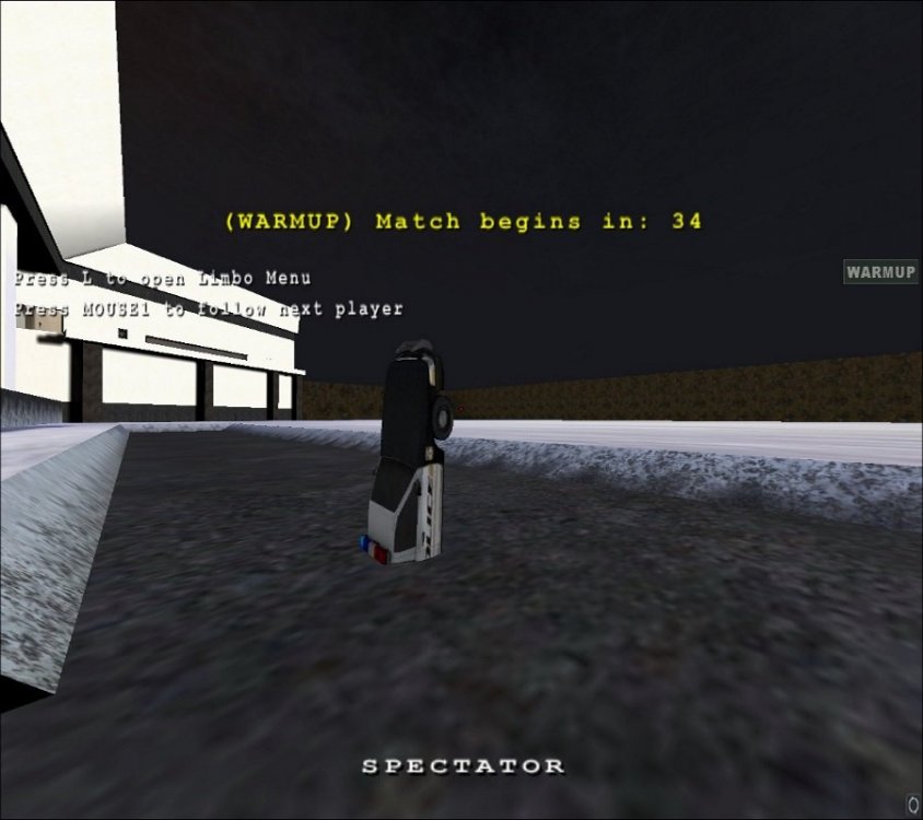

donc enfait la seule chose qui me reste a savoir c'est comment retourner la voiture dans le bon sens et comment faire pour pas qu'il disparaisse

Your car is running down the x axis of the origin brush you need to give it a face angle
inside of police_car_a where you need to show police_a you add
faceangles 0 90 0 50
you can figure it from there

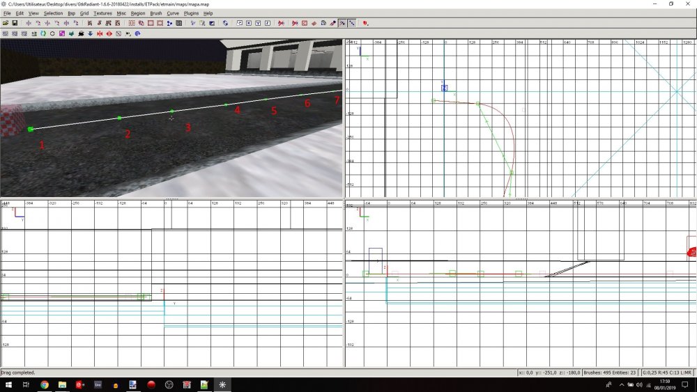

Hi! @DoubleDragon
I managed to configure the model in the right direction, just configure it in the right order in a 3D software (Blender, 3ds Max).

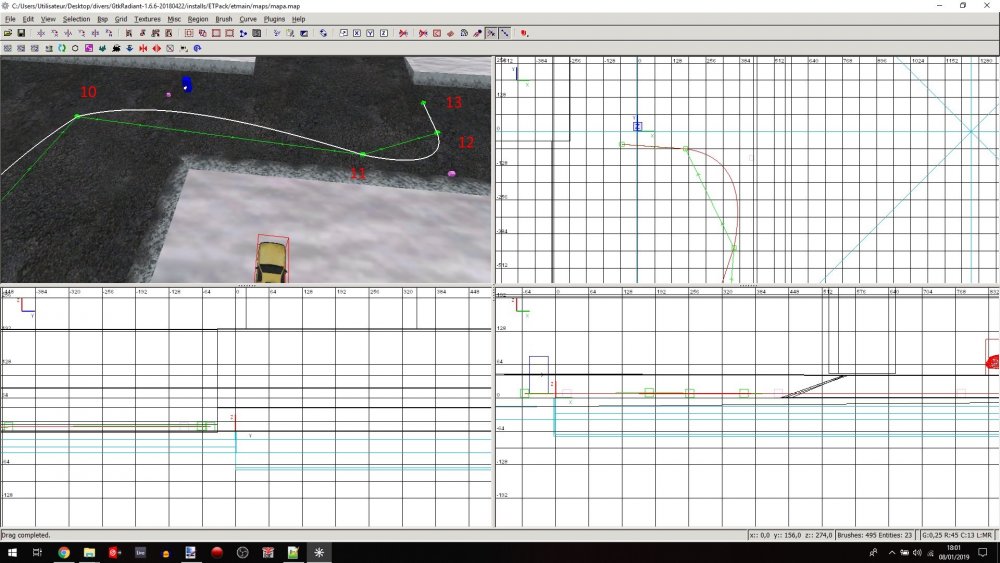

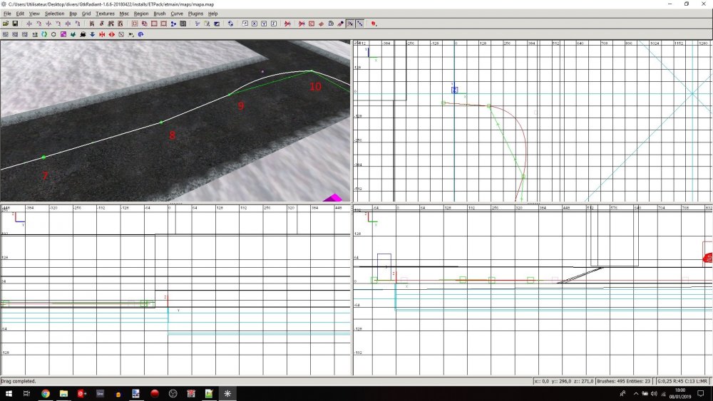

So good for the "sp_02 / sp_12" except that now, when the model arrives at the last splines, it changes axis, it does not go, an idea?
For informations!
the "tag" is a small object inserted since 3DS max, or Blender, which allows to join a model, to see here
https://forums.splashdamage.com/t/gtkradiant-misc-gamemodel-script-mover/233677
In game, Enemy Territory does not support a group of more than 1025 verts, that's why I "split" the bodywork of my car, it includes more than 1025 verts, when it divides, it passes ( if you tell me where to do a tutorial, I would do it with all the details), so no need for "tag" or "misc_gamemodel" or "misc_model" I'm going through the script_mover:
value:
models2: models / mapobjects ... etc
So the only problem is the car arrived at the last spline! (picture)
My script without "tag" or "model"

(And he work ! )
Edited by Young Fox
Ok guys
it's simple
If you have 13 splines for example, then you will have to stop at 12 in your scripts, otherwise it will create a bug in your script_mover.
